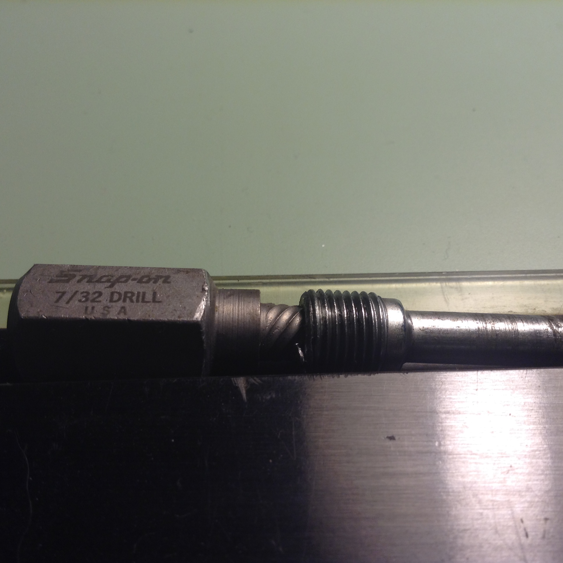

Front brake caliper slide pin inside hex rounded out. Brand new hex tip will not engage, neither will a torx bit. I put the caliper in a vice to better work on it. Plan to soak in penetrating fluid. Anyone have this same problem and get the little bastard out? Will order new pins tonight. Damn, my bike is down now. Had to pull the brake pads out cause my dumb *** got some oil on the rotor and pads. I am thinking about drilling out the thing but will still have to address the remaining threads after getting the pads out.

After my last I remembered that buried in my toolbox is a set of easy outs, snap on brand, that I have seldom had need for. A few minutes after soaking in nut buster I hammered my 7/32" easy out in and gently turned my long *** 7/16" double box end wrench and she came loose. Dave breathes a sigh of relief because he didn't jack up the caliper in the process. Bitch was tight. Tried a chisel and just peeled off metal. I guess compared to the cost of a new caliper the easy outs paid for themselves.
