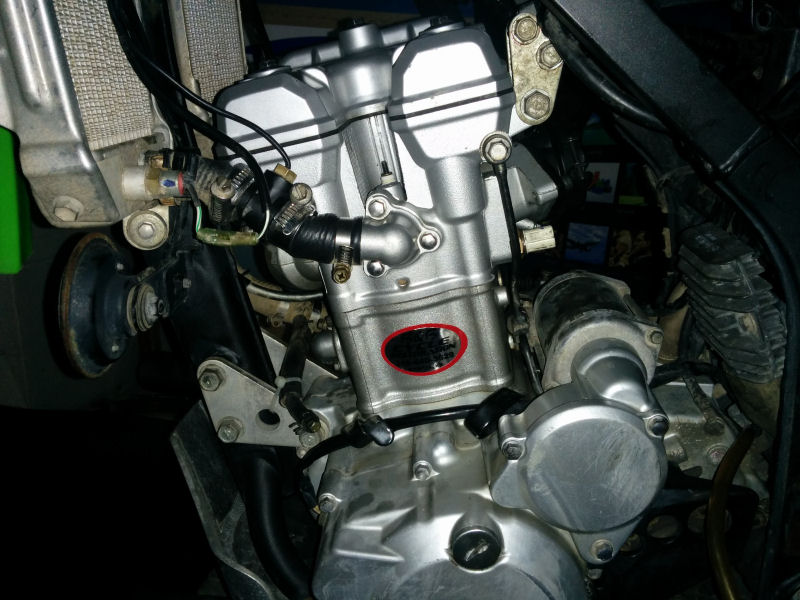

Well, finally, I kicked off my project today thanks to my mate Chris being kind enough to help me out. I tell you what, I'm only too glad he did help me because after today I realise that I would not have been able to do it myself. Not only did 2 sets of hands help, but Chris' knowledge and tricks were invaluable!
I had done as much preparation work as I was comfortable with doing before he came. Coolant was drained, tank, seat, header pipe and cam chain tensioner were all removed first. Then I whipped off the cylinder head cover and cams and wired the cam chain up so it didn't fall down into the case. I also laid out all the tools I thought we would need, and had cleared surfaces so we had space to work on. And I think all of that prep-work was WELL worth it!
Cylinder Head

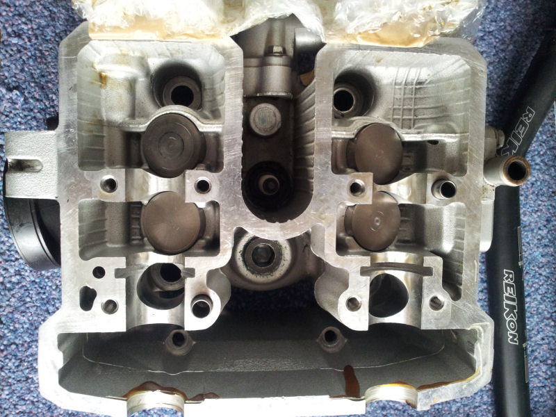

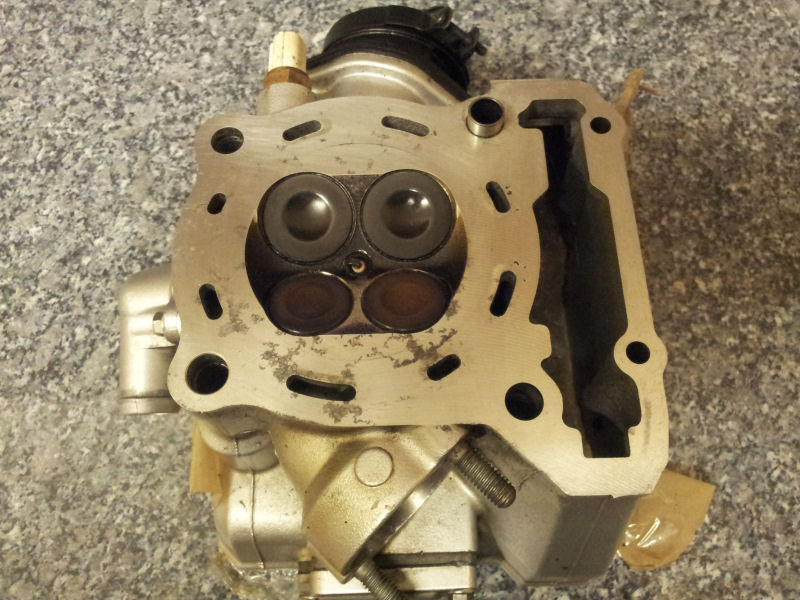

I strongly suspected that my valves were done and needed re-doing, so I had phoned up a couple of places to see how much it was going to cost me to have them re-done.
Fortunately Adrian here on the Kawasaki Forums was selling his head so I bought it. Admittedly it was a gamble buying it as it could have been totally stuffed but Adrian sent good quality photo's beforehand and it seemed OK, so I took a leap of faith. As it turns out the assembly was in good condition with the valves still in spec with what looks like stock shims.

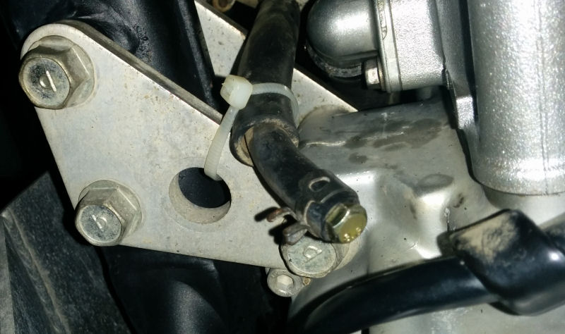

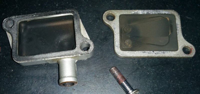

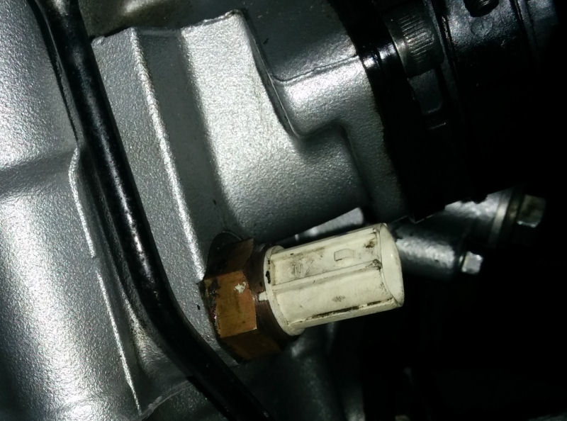

The head is off a US bike though I think, so unlike the Australian head which has the emissions system all closed off (actually, it looks like the Aus one just hasn't had the holes drilled out of the cast and a reed valve put in it).
Fortunately I had some Exhaust Cement at home so I have filled the hole in and will look into getting a blacking plate to cover it nicely. There is also a difference in that the Aussie head seems to have a coolant circuit coming off the radiator whereas the replacement head had a temp sensor in that hole instead.
Strangely, the sizes of the holes is different so I couldn't just remove the temp sensor and plug the pipe connector from my old head in. So instead I have just left the temp sensor in and I have blocked off the coolant circuit with a bolt in the end of the pipe and a clip to keep it in place.

With the barrel installed we slapped on the new cylinder head and install the cams. Fortunately for me Chris insisted on re-checking the cam timing and we discovered that I had put the cams onto the chain 1 tooth off where they should have been. We went through the process of adjusting it and then bolting everything back together for the second time, and this time we were happy that the timing was right. If it had been me doing the job on my own I would have thought the first setup was OK and no doubt would have trashed the top-end.
Chris helped me get things back together to a point where I can go through the process of getting it into a running state now. I need to put coolant in, new spark plug, re-jet the carb and fit it up again, and then temporarily fit the tank again to see if I can get the bike running. I just need to motivate myself to do it now as I am feeling pretty stiff after yesterdays ride. Here's the final 351 Big Bore Kit and new cylinder head installed:

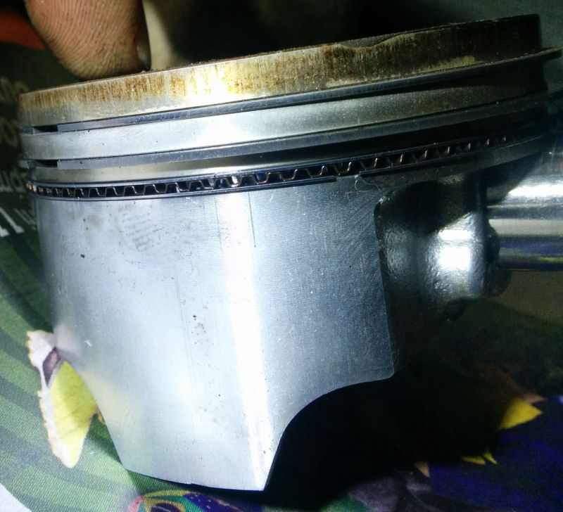

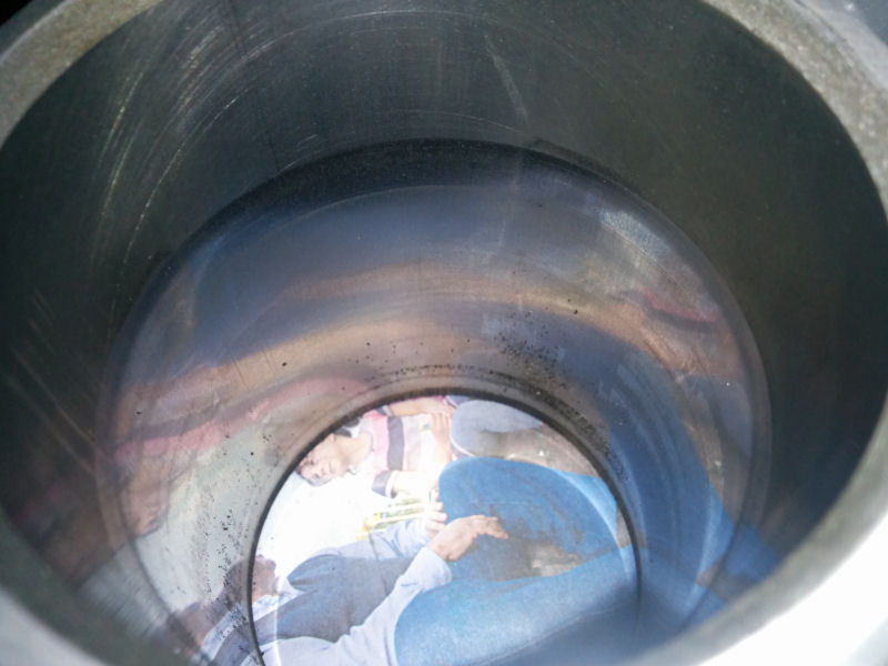

After removing the old cylinder head we removed the old 250 barrel and piston. Now, I must confess to not knowing a hellava lot about being able to identify a "good" or a "bad" piston and barrel, but I do know you want your bore to have nice cross-hatching and my old barrel was like a mirror!
On inspecting the piston we discovered that the first compression ring (the top most ring) was actually stuck with its gap closed, so it was nearly flush with the piston. It took a bit of fiddling to loosen it so it opened properly. Surely that could not have been helping matters with the compression? Chris then told me that the "technical term" for the pistons condition was F#CKED!! So the top end rebuild was clearly justified!
