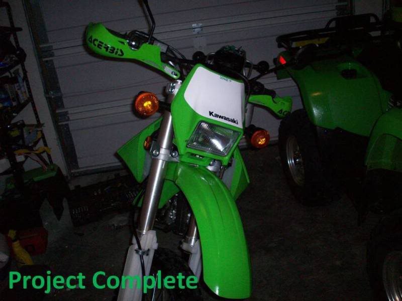

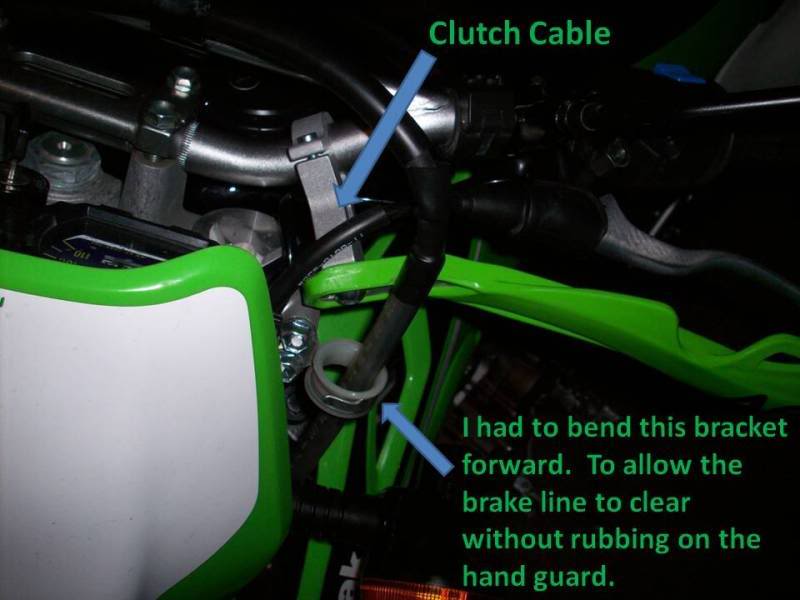

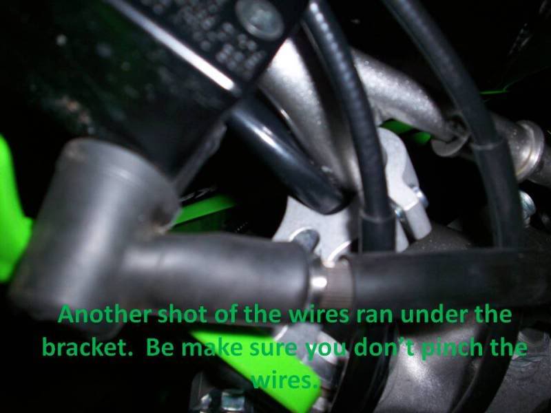

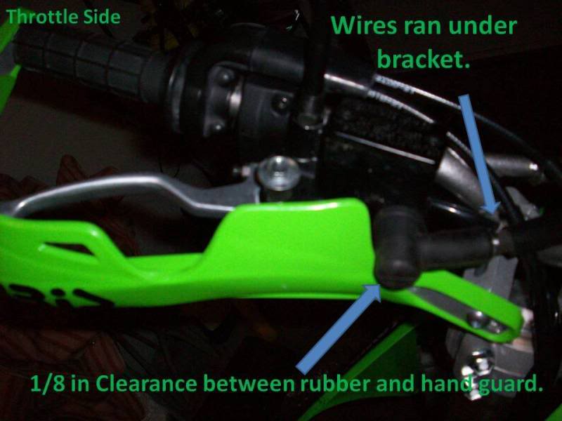

I just installed the Acerbis Rally Pro hand guares today. Here are pics of how it turned out. The biggest issue I had was with the clutch cable. Its a little tight. If anyone has a better solution please let me know. I tried to run it through the mount but the gap was not wide enough. I didnt want to drill it out, I may take it back off and drill it out. If you have stock handle bars, I recommend you use an electric (non cordless) high speed drill to drill them out.
