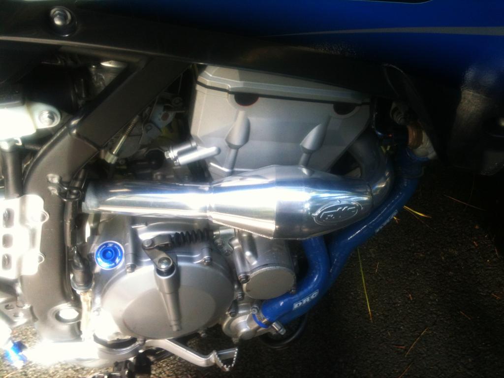

Yep thats true, theres pictures somewhere on here.
Had mine ceramic coated, still gets pretty hot but dont have to run the heat shield anymore.

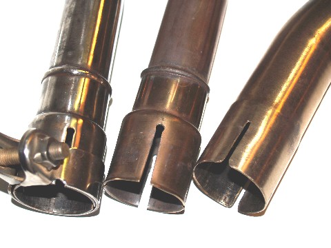

I had a chance to take another look at the header tonight.
The bomb pipe is 1/4 inch wider diameter than stock. More flow = more go.
The bomb is hollow. No pass-through pipe with holes drilled in it. Not sure if that is good or bad.
The pipe appears to have the correct bend and the openings line up with the stock.
The stock weighs slightly more, but that's with the heat shield attached to it.
My two major concerns are:
The total length which is 3/8" longer than stock.
And, not sure how I missed this...but...THERE IS NO FLANGE. How would I be able to attach this to the muffler?
The pipes diameter is the same as my FMF Q4.
The stock muffler easily fits inside, but there isn't any type of collar on it at all. Even if you could clamp it down, it's not a good fit.
Pretty sure I know why FMF let that one slip through.
Think it's probably refund time.
Any suggestions?

You really get your money's worth... Glad I got a real fmf part.
You could slot the end of the pipe like stock
https://www.kawasakiforums.com/forum...fpowerbomb-jpg

Being the same diameter, I don't think It would be a very good seal unless there would be a way to flare the pipe past the slotting. I'm sure it's possible, but is it worth it? What about a slightly larger connector piece in between with slots on both ends, two clamps and...every way I look at it, it turns into more time and money. That, and I still don't know if there will be any change to performance.

Meanwhile, you can always shorten it; consider buying a short section of exhaust pipe with an ID the same size as your OD so you can just use the short section as a pipe to pipe connector?
