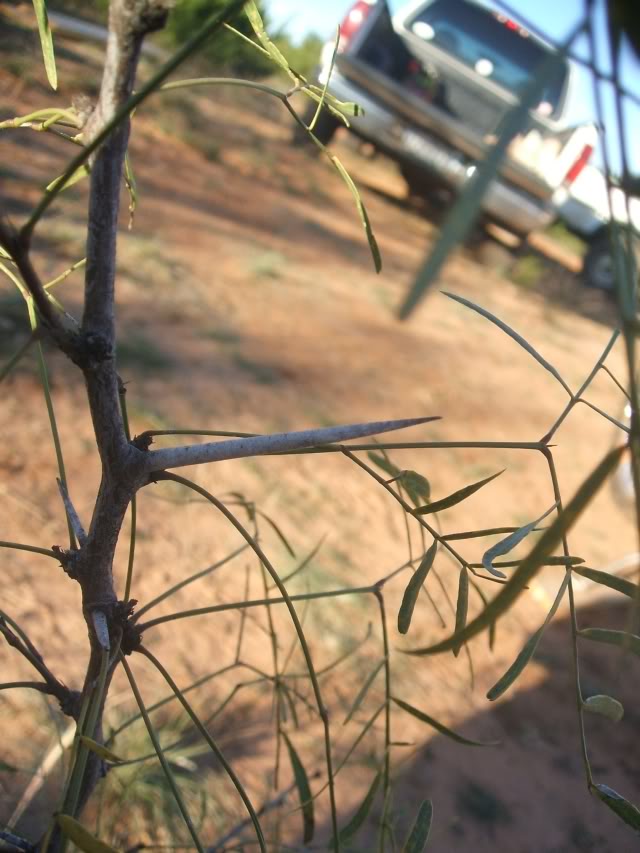

Flats have more to do with terrain and debris than it does with the tire, I believe. There's so many thorns and sharp rocks where I ride and that makes flats fairly common.
Change them enough and you'll feel like Dick Burleson out there on the ISDT trails.
Mesquite thorns are your enemy...

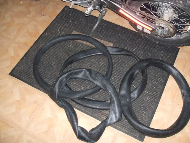

The Casualties... (I patched and save a few of these for backup tubes)
