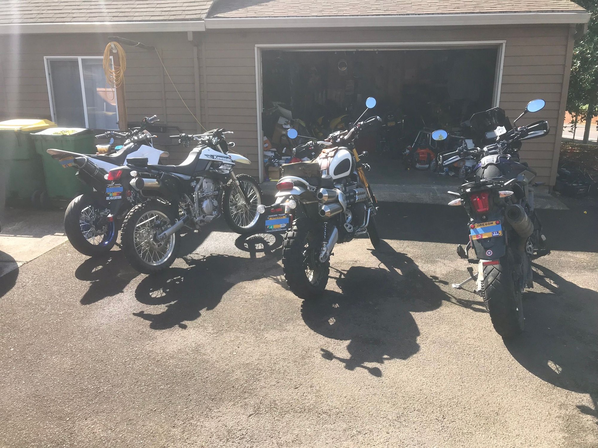

We did have an ugly tail competition here yesterday though:
Group shot for tail tidy.
The clear winner was Kawasaki Heavy Industries with their stunning rendition of "she ain't heavy". It pains me to think that I actually "paid" to circumvent Triumph and install an extender on the Tiger's fender. The "probe" attachment from Triumph on the Scrambler there is a CLOSE runner up in aggro however, I have already ordered it's replacement as I'm sawzalling the thing off. My Son's little WRX looks tidy- that's the tail arrangement I've got- just haven't soldered it all together yet (OLD eyes).

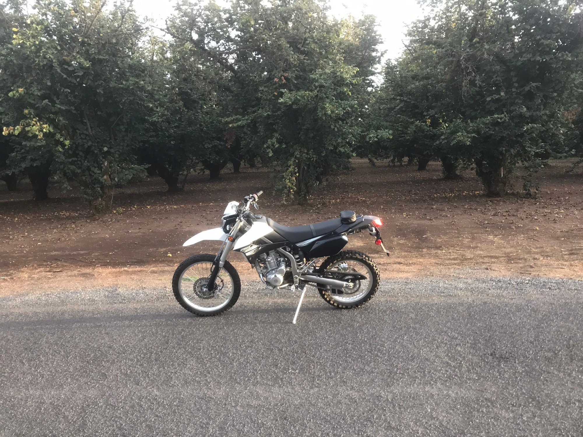

I'll include another side view of the little beast as it sits- this is from yesterday's dirt familiarization (GRIN) ride. It rides VERY similar to my Son's bike in that I can throw myself headlong into 25 mile corners in 5th at 40+ and try to "gun" my way out- addicting to say the least and very unlike the big Scrambler where third and idling is pushing it on these same corners.
On Jaquith road headed for first time dirt
I'm very pleased with this little bike so far although I have ran it out of gas necessitating a fill in my driveway. Fortunately I had a reserve so I could get those last few blocks- I even remembered how to switch on the move when it sputtered at first!
