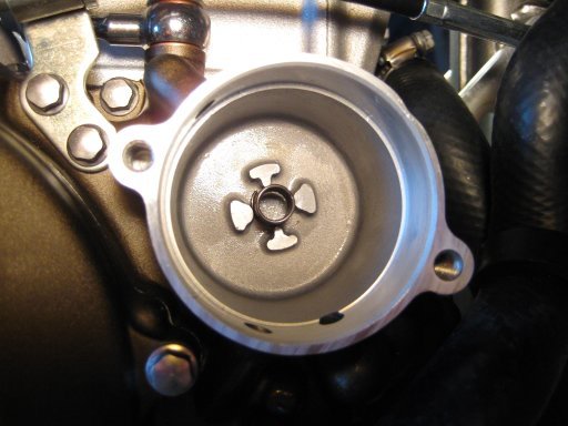

i did the grease on the end of the spring thing for a few changes and didn't encounter any problems. since i expanded the end of the spring it stays inside there all by itself. i haveused that 6015 filter since the bike was new and have not had any problems with it.
My first mod... I tried lcpl's trick of expanding the end coil of the spring behind the oil filter so it stays in place while installing the new filter. It was a little tricky getting the expanded coil in place, but once it was there it held the spring in position with no problem. You can see the expanded coil peeking out this pic.

ORIGINAL: deej
Oh and on the oil filter cap, I thought it couldn't go on upside down. But then again I always look at the oil ports to make sure they are lined up. Perhaps we could all put a smiley face sticker or a K on it so we would always know. Just a thought.
Also, I reexamined the capacity to mistakenly install the oil filter cover wrong by turning it 180°.deej is correct, it cannot be installed wrong. The bolt holes would misalign. So no need for smiley face stickers I guess.
One last thing, the Fram filter CH6015 that I bought differs from the original Kawasaki filter. The Fram prevents the oil filter cover from fully seating. Upon closer inspection I discovered that the spring well of the Fram is 1.0mm (0.039") shallower than on the original Kawasaki filter. You might be able to perceive the difference in the pic below.
I know lcpl and others are using Fram filters on their KLX 250s with no problem. Hopefully mine just came from a bad lot.

ClassicMe, Interesting about the Honda filter. I wonder why it is less expensive.
Cosmickites, sounds like you are moving right into some great mods. I look forward to hearing back from you on how these change your bike's performance.
All, for whatever it is worth, here is how simple it was to expand the bottom spring coil (for oil filter); held the body of the spring with a paper towel, grabbed the end of the wire in the last coil with a pair of pliers, squeezed pliers and twisted the end outward about a quarter turn. It sprung back to the perfect size to fit tightly in the mounting lugs in the back of the oil filter housing.

I just lay my bike down and put it back together.... it needs a nap sometimes too....LOL... no grease, or bending spring.

Yup, laying the bike down worked for me too. No more nappy time for my KLuX[&o]
