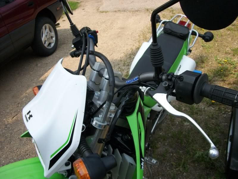

Here's a photo. Not on the trail, just in my driveway. It's dirt though.

The bars in the the mock titanium color. They call it "Tanium". Looks good I think. The new bars are really light too. I couldn't believe how heavy the stock bars are! They feel like they're filled with lead. Let's see - too low, they bend easily, they're boat anchors, and attaching handguards is a pain with those welded end plugs. What's not to like, LOL. I liike the new bars.
Haven't decided on brush guards yet. I left the cheesy stock handguards off. I like the nice clean open look, but if I decide to try some single track I'd better get some barkbusters on there.
I have a pair of Ken Sean dual sport mirrors instead of the stock lollipops. You can fold them out of the way for dirt riding and they don't stick up as ridiculously high as the stock mirrors. I like them.

Nice looking, and I like that bend you chose.

righteous set up. Thinking about doing something similar. I just dont know which bend etc to get. Nowhere here has hardly anything in stock to compare to so I dont know what to get! Those look great.
