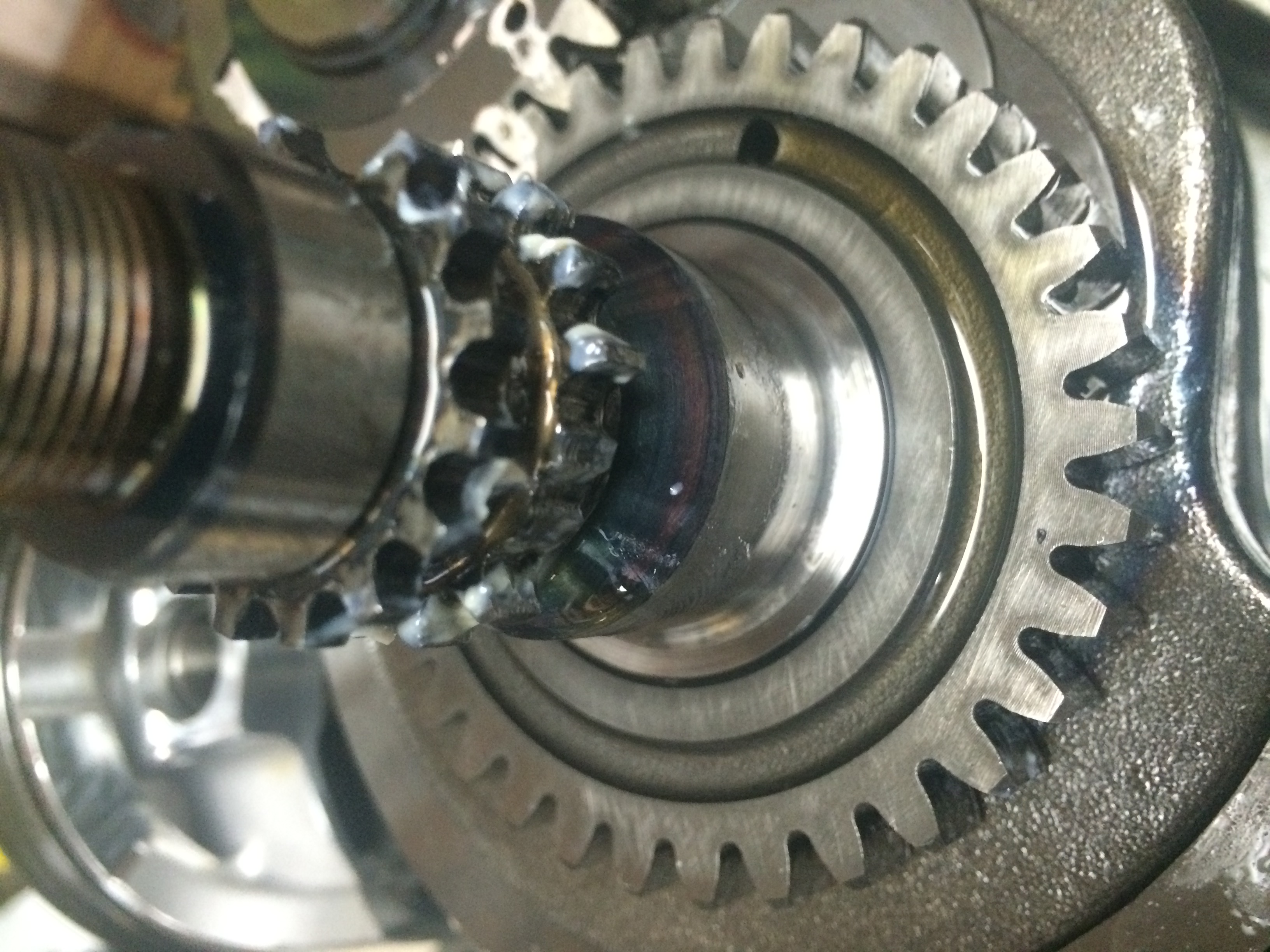

Had a chance to do a little more digging into the engine tonight.. Not good news. 2 teeth on the crankshaft are busted!

Oh man that sucks. Never seen that happen before. I believe only Kawi offers a crankshaft.
On second thought you may want to check with Thumper racing. I thought at on time they had a stroker crank. Would make your efforts more worth it.

bike bandit lists the crank, but it's spendy.
What do those gears connect too? I would investigate further on all the connecting parts for those gears. The matching gear/component is suspect also.
There is some reason those gears sheared off. I could see one tooth as a metal defect, but 2, no unless the second one let go due to the first failure.

No doubt, i see it in ring and pinions all the time. All you need is 1 tooth to let go and it will nuke multiple others from the debris.
I knew that was a bad noise.... just didnt sound right. Sucks about your crank OP, probably cheaper to get a used assembly off ebay.
