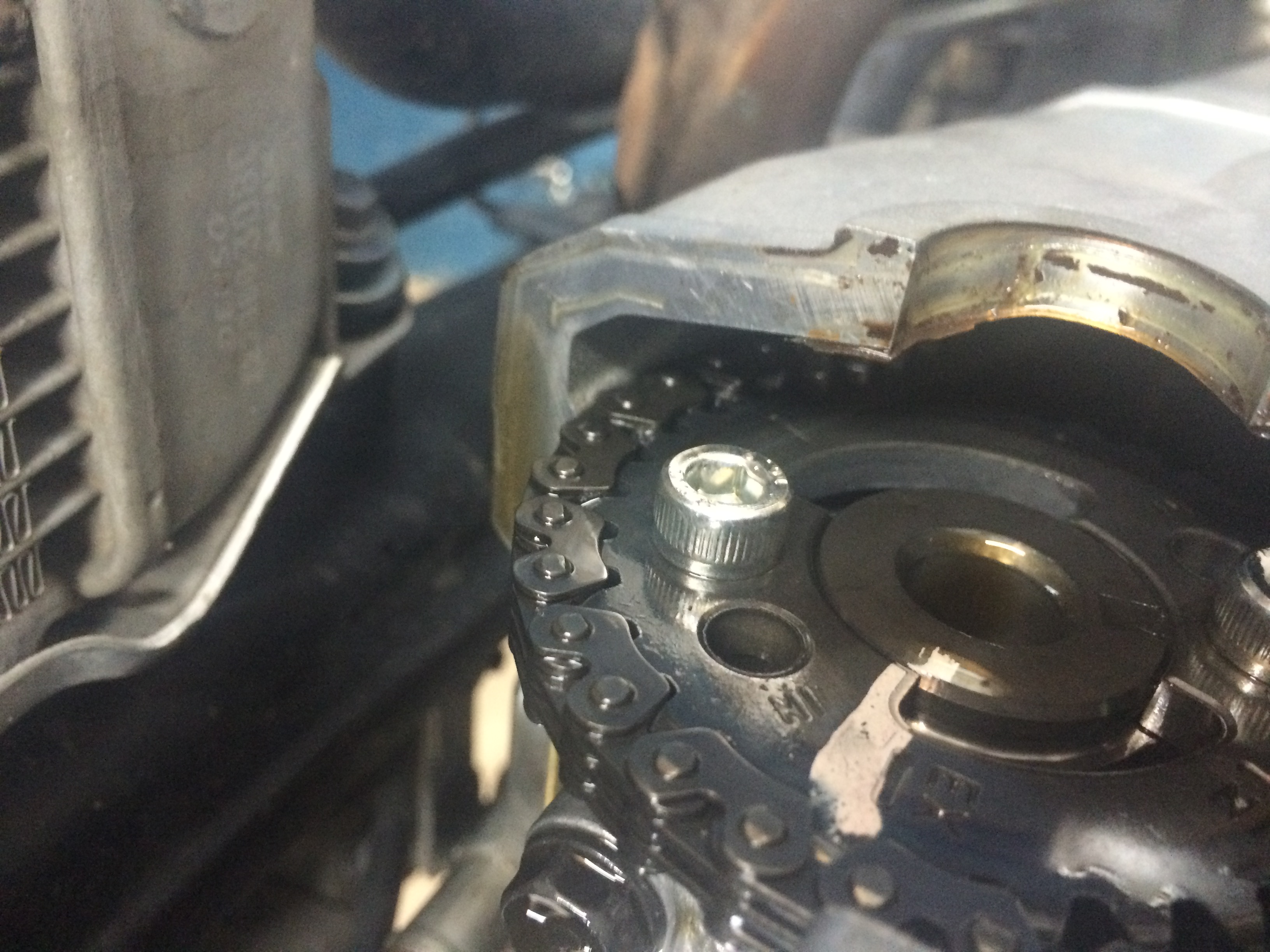

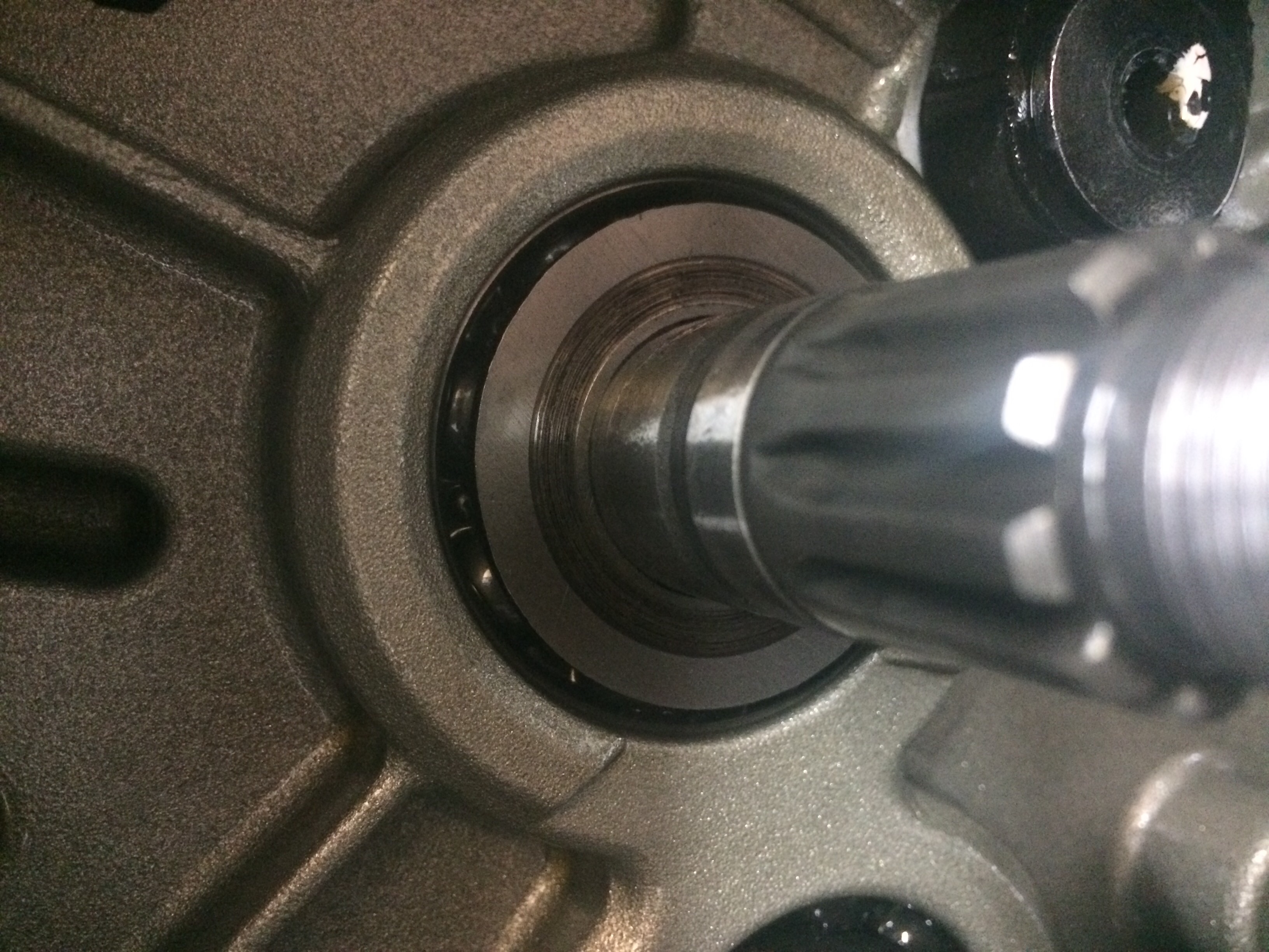

Update. Tore whole engine apart. No bearing issues in gear case. Noticed that the washer
Behind the clutch pack has had some spinning wear not too sure why yet. Only thing I could find related to the noise was on the exhaust valve the timing chain was flexing off the cam gear as the cam was pushing the exhaust valves, would this be fixable by tightening up then tensioner or are we looking at new cam Chain and guides ?
