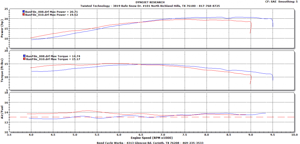

Todays Chart on top - DJ136 , Needle on 3rd notch, DG-R
Previous Chart bottom - DJ132, Needle on 4th notch, DG-R in Red, Full FMF in Blue
Lid off, MCM, SAE corrected HP and TRQ

It's a shame the RPM range is different. But it's still easy enough to compare if you pick your points of comparison.
I'm not seeing much of a difference comparing torque curve.
Like looking at 8k RPM, the new #136 may have a little bit more torque (13? vs 12.5).
And also no weird small dip between 5 and 5.5k RPM.
Any advantages the #132 have over #136? So far I'm not spotting anything.

You've got figured out Zeno. All I really got out of the 136 was a smooth curve - a more steady power delivery with minor increases showing on the new chart. The seat of pants is a strong power delivery when snapping to WOT from any starting RPM..
