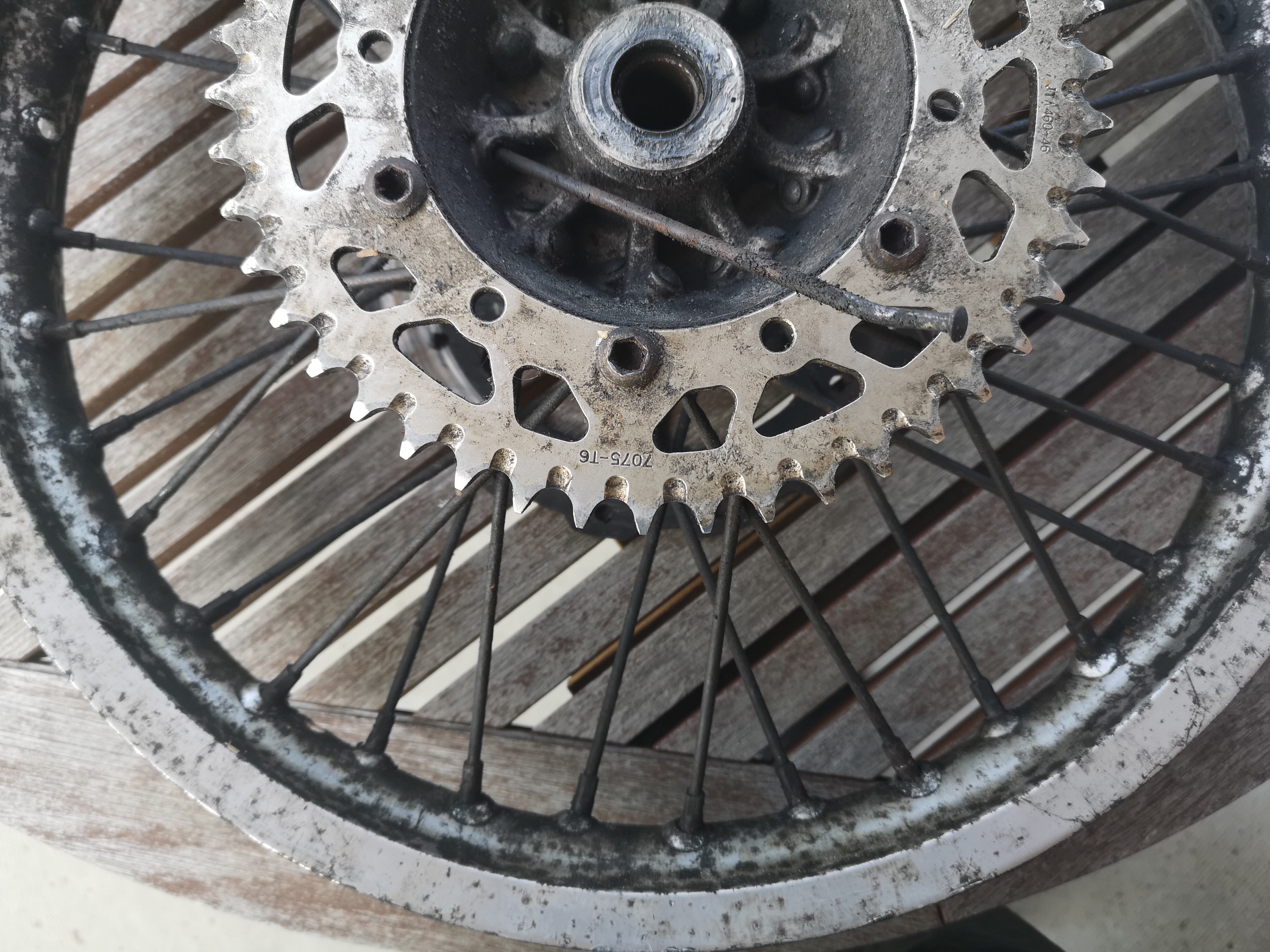

well i have now started what i will call phase one.
My wheels have been striped down to hubs and rims, and i have oredered new spokes "custum made"
My rims will get a shiny black with stock hubs and spoke getting stock collor. (powder coated)

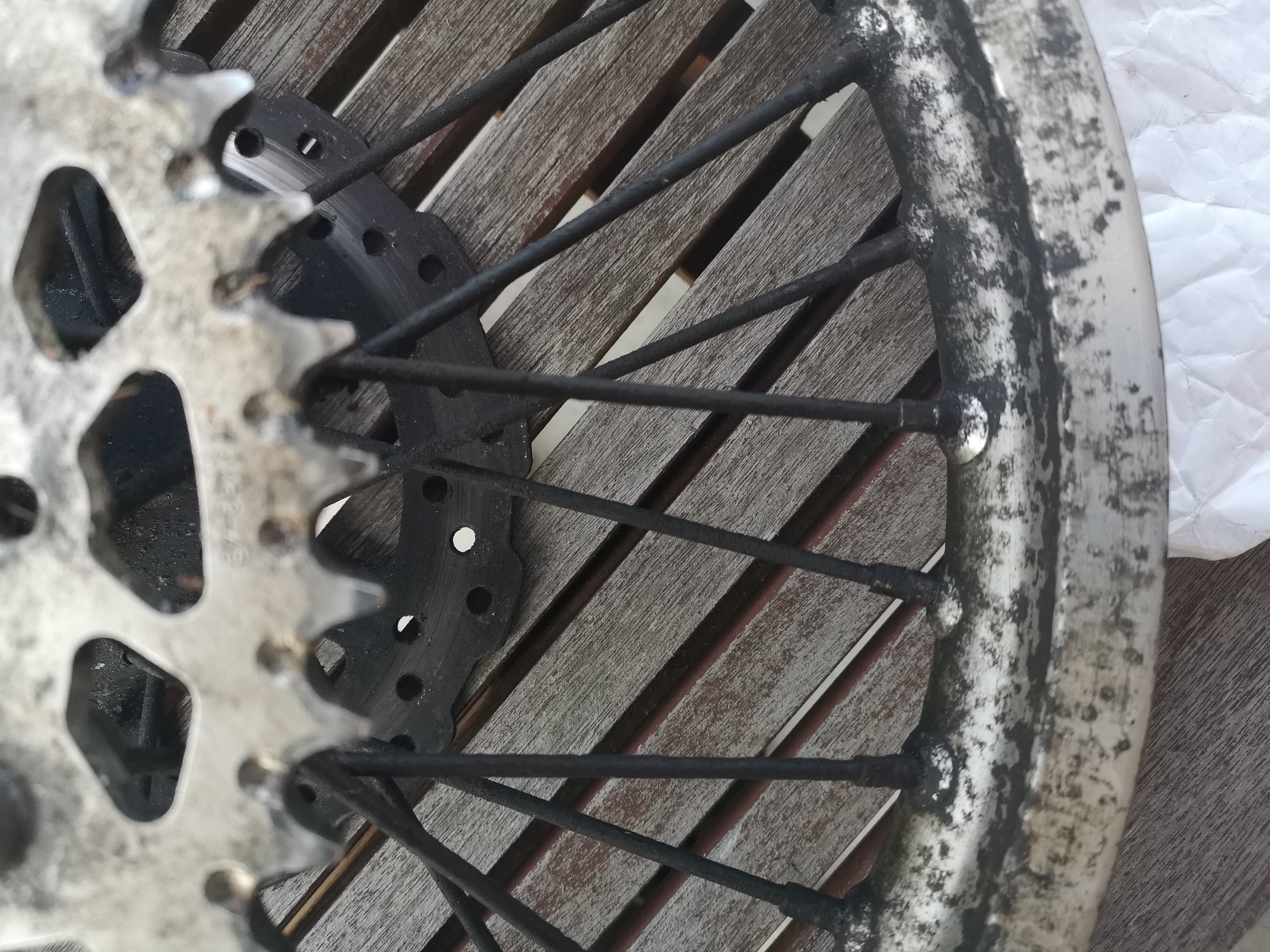

here is a shot if the rear wheel before i un spoke it.
these pics remind me the value of ACF 50 since i forgot this winter and did not get it cleaned often enough. (pricy mistake)
re asemble will be in a few weeks while i wait for parts i will give the rear caliper a refab kit with piston. and do some other maintanence ont the rest.

some of them where coroded badly under the grime. and some broke when taking the wheel apart for powder coat.
