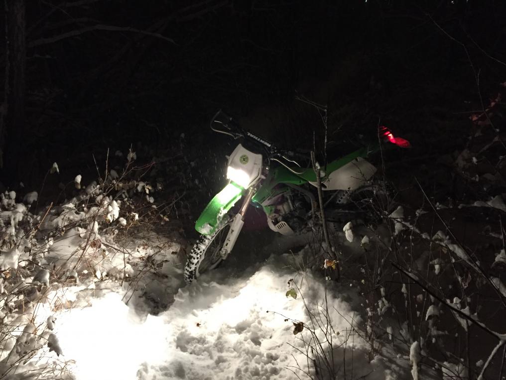

Thanks for the help guys!
I ended up borriwing a pipe wrench which I was able to use for leverage. Once it was in place there was more room then expected.
Managed to take it out for a quick spin.

Got snow? LOL.
Glad you got it fixed.
