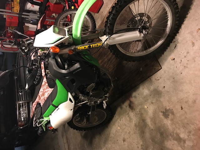

When I first got my 2007 klx250s, I started it up for my dad and he LAUGHED. He laughed and laughed and through his laughter he choked out "That's the most feminine bike I've ever heard!" He was right, we named it, "the Princess bike". I got the klx because I have a friend who swears by the 300 and it felt way better ergonomically than my husband's DRZ400 (not to mention 50 lbs lighter). We ride mostly in deep deep sugar sand here in florida and I knew the stock 250s probably wasn't going to cut it, but I bought it cheap and planned on doing the 351 with the Barker Exhaust.
I got lucky on craigslist and found a 2014 fmf powerbomb header with a PC4, along with a dynojet kit (DJ2152) and 13 tooth sprocket all for $250. Everything was only a month old when the guy decided to trade in his bike and kept the upgrades to sell separately. WIN!
I put on all of the above, and with some help from Klxster, I jetted the carb. I used the DN0228 needle from the DJ kit, with the clip in the top knotch and two washers super glued on top. I am running with a #40 pilot jet (perfect for Florida elevation) and a #157.5 main jet. Lidless airbox. I took her out for a drive and she pulls HARD above 6k rpm. I couldn't tell a huge difference driving slowly around the neighborhood, but on the street... WOW. I no longer worried that I wouldn't be able to get out of the way in an emergency on the highway.
I was on the fence about doing the MCM mod. For me, it's a scary mod. Scary because it's a free mod, unless you do it wrong... then it becomes a very expensive problem. But I liked the idea of gaining the extra torque below 6k rpm. It's really not a difficult mod to do, just scary. I liked that klxster had dyno'd his bike and could prove that it made a difference and that his bike didn't have any negative effects.... so... I did it.
Once again, I couldn't feel a huge difference in the neighborhood. HOWEVER, I just tested all of my mods this weekend in the Ocala National forest. I couldn't be happier. I was so happy with the performance that I am no longer planning on putting the money into a 351. I had all of the torque and power that I needed for what I was doing. It is SUCH a different bike! So different, in fact, that it's name is now "Mr. Princess", aka "The Tranny Bike". He's no princess anymore. If you are on the fence, I highly recommend doing these mods FIRST. I also recommend contacting klxster for help. That guy has this down to an art. Also, the most recent info for doing the MCM mod is not clearly written in the forum that I know of. It's a lot of outdated information that is going to create a lot of unnecessary work. If I have time, I will do a new write up on it.
Either way, it was awesome! Do it!

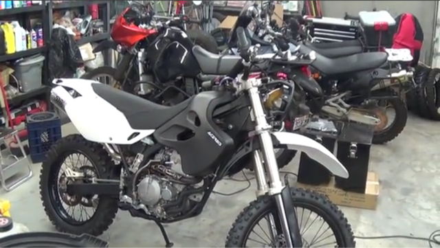

Here is Mr. Princess. The black and white bike is what he will eventually look like. It belongs to MrDuhfactor who did a great series on youtube on a 351 build https://www.youtube.com/user/MrDuhfactor
