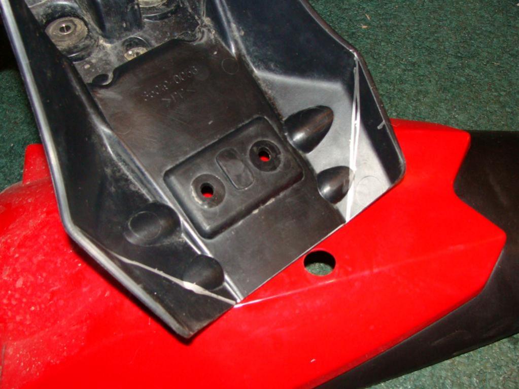

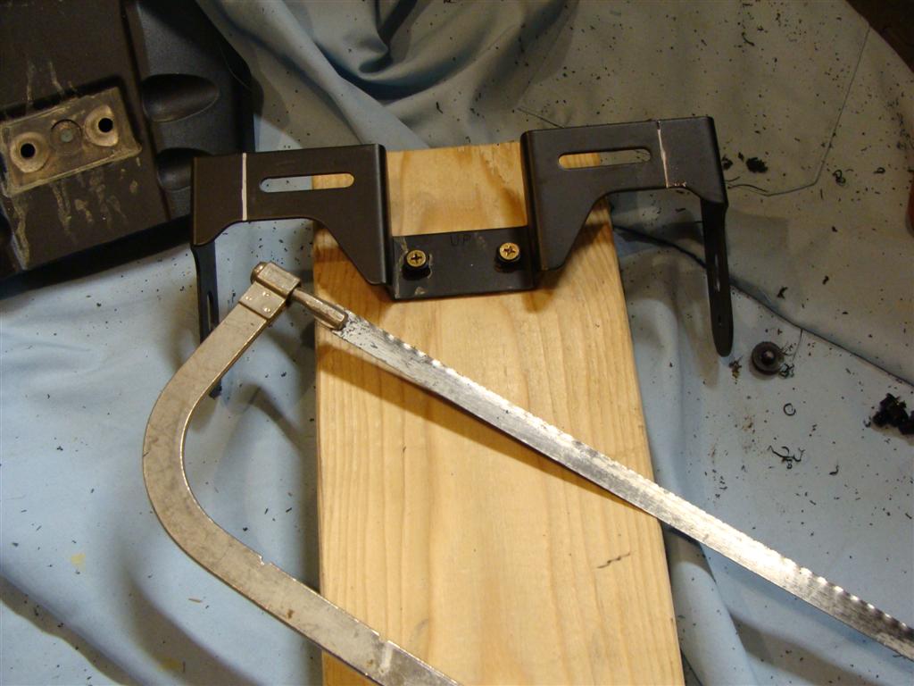

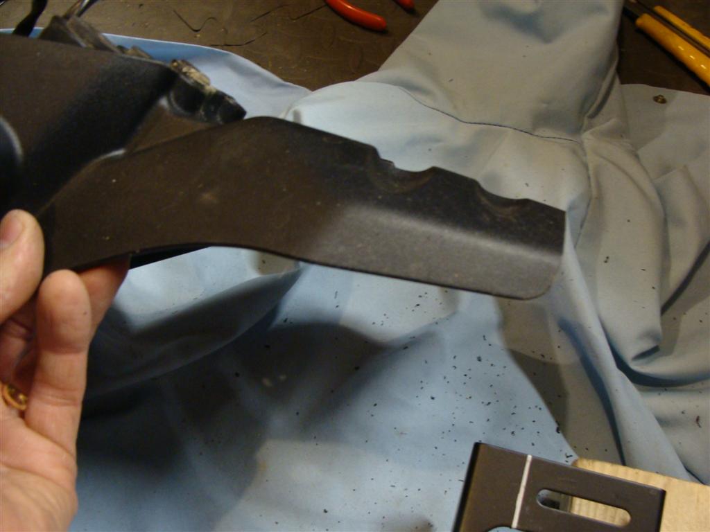

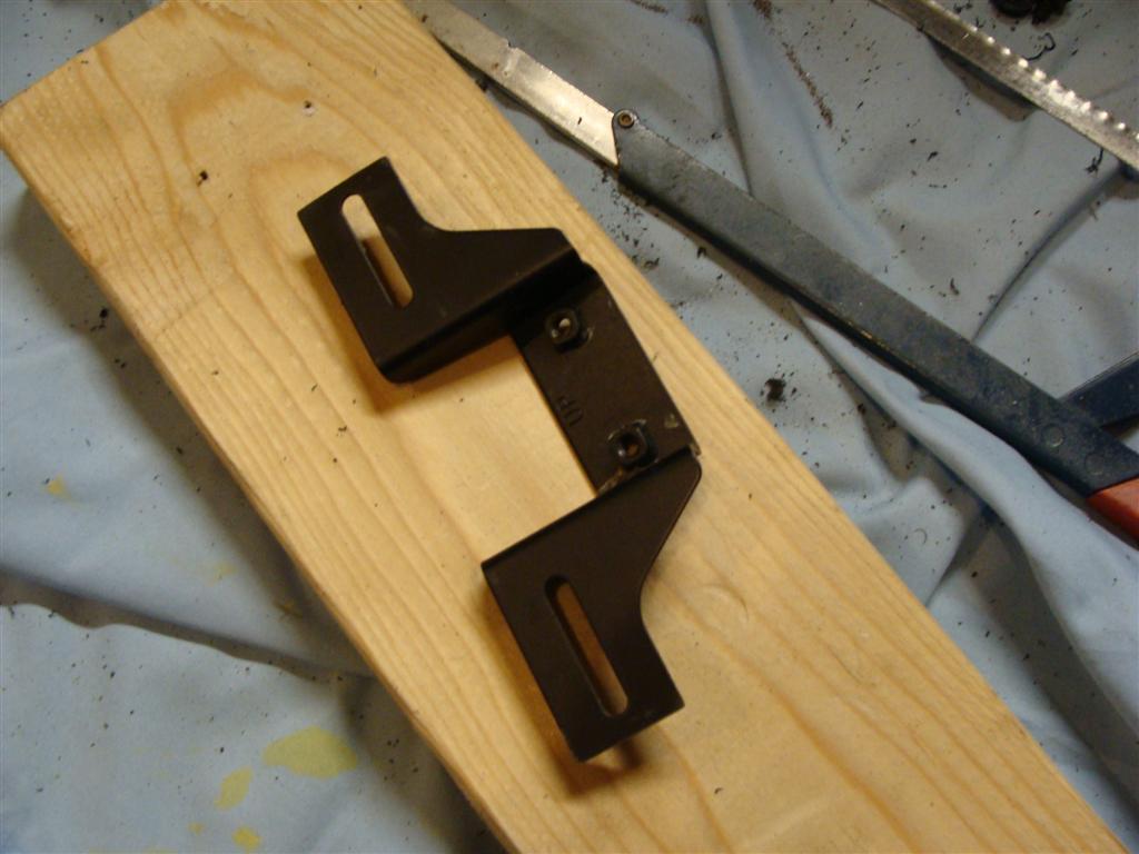

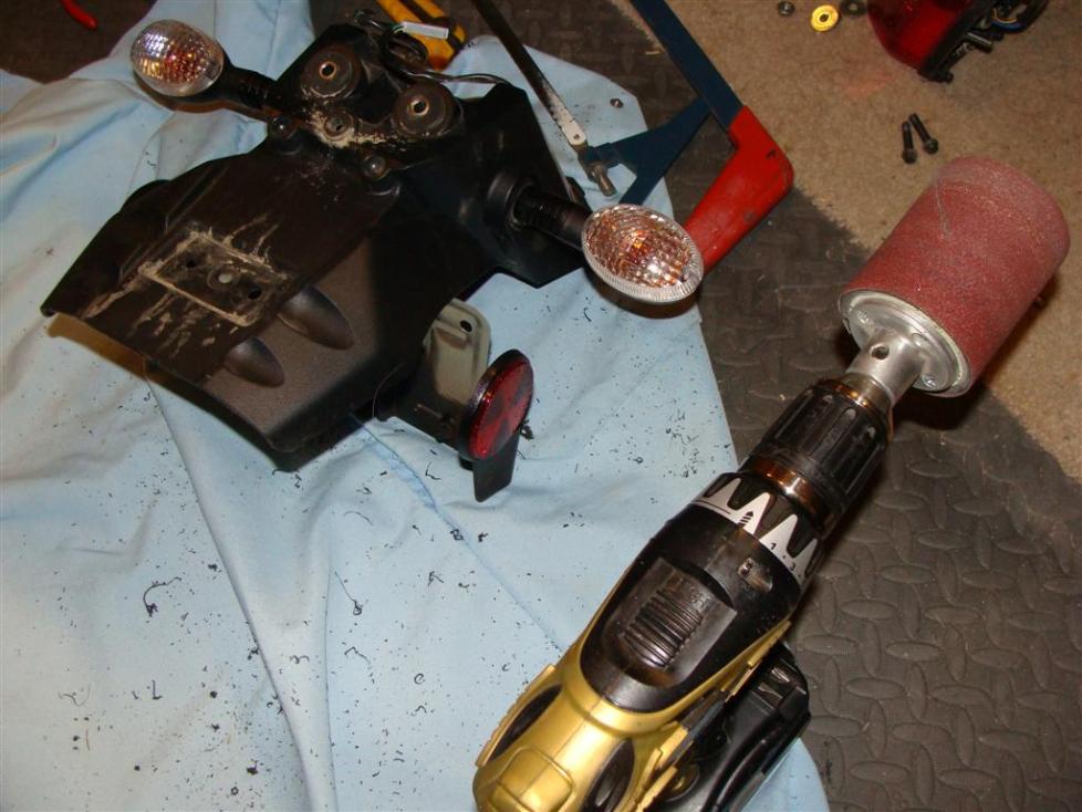

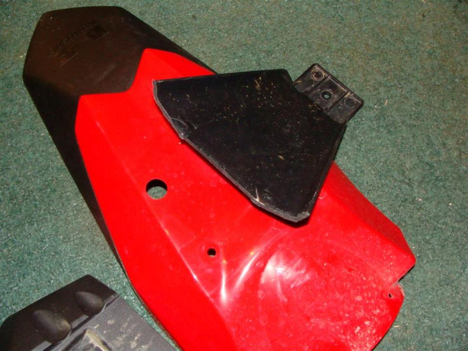

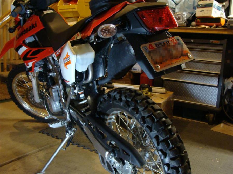

Well, you guys inspired me...
I did the tail bob on my '09 this morning. Took some pics along the way, so you can kinda see what I did. I just used a hack saw and a drill-mounted drum sander, and it came out pretty decent.
I just took a silver Sharpie and drew a line on the underside of the fender from dimple to dimple, and just cut it straight across. You can see that I was going to taper it from the one picture (silver lines, but no cuts), but decided not to. I put a small radius on the edges. I thought it looked better that way so I skipped cutting the angles. I screwed the plate bracket to a 2x6 for cutting, and again, used my trusty hack saw. I did touch up the bare metal with some Epoxy paint so it won't rust... not that anything really rusts here in Utah.

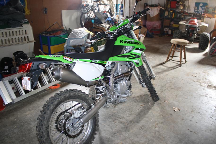

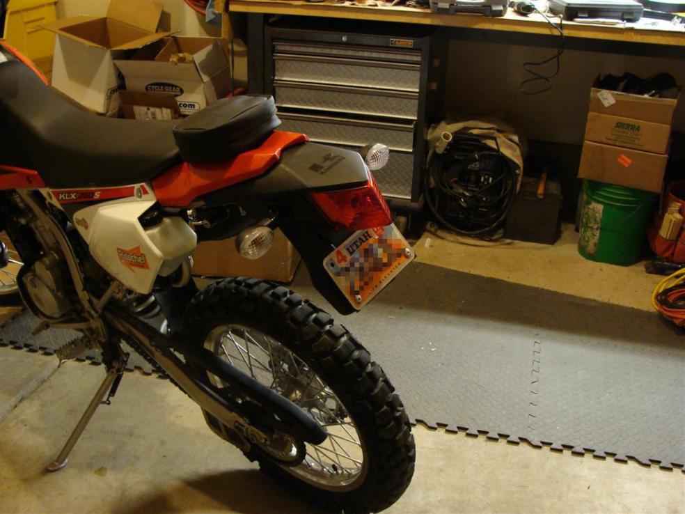

Here are the rest of the pictures...
I did the plate bracket flip as suggested by others, and I attached the plate with some SS rivets. Shouldn't come off now!
I also ditched the front side reflectors while I was at it. Now, it it would ever stop raining and *snowing* , I might be able to get some riding in...
