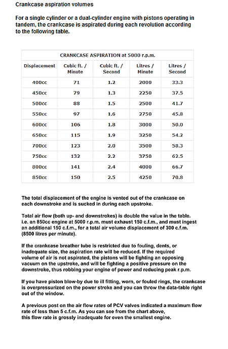

So a 250 actually reads at the 500cc line; 88cfm when factoring the up and down stroke.
Probably not a big deal for trail work, but if you do a lot of high rpm then every little bit might help

All my modification was done for was to cut some of the dripping of oil. There isn't really a way to avoid blowing off oil on most singles when run at a bit higher rpm. Just keep an eye on the oil level, that's all I do.
Of course the piston going up and down at high speed results in a lot of cfm in the crankcase. But if those cfm can't escape, it does not necessarily result in power loss. The energy taken in the down stroke to build crankcase pressure is mostly recovered in the up stroke. Air in the crankcase acts like a spring.
Some escape is necessary to avoid pressure buildup due to blow by gasses, which is the main reason for that hose to the airbox. Correct me if I'm wrong.
So, I am not really surprised by the lack of performance gain from enlarging the crankcase breather hole.

That's 88cfm at 5000rpm btw; 176cfm then for an engine at its' ignition shut off of 10,500rpm like KLXs
Once you've exhausted the normal mods and their possible gains, there may hp hiding in other places
