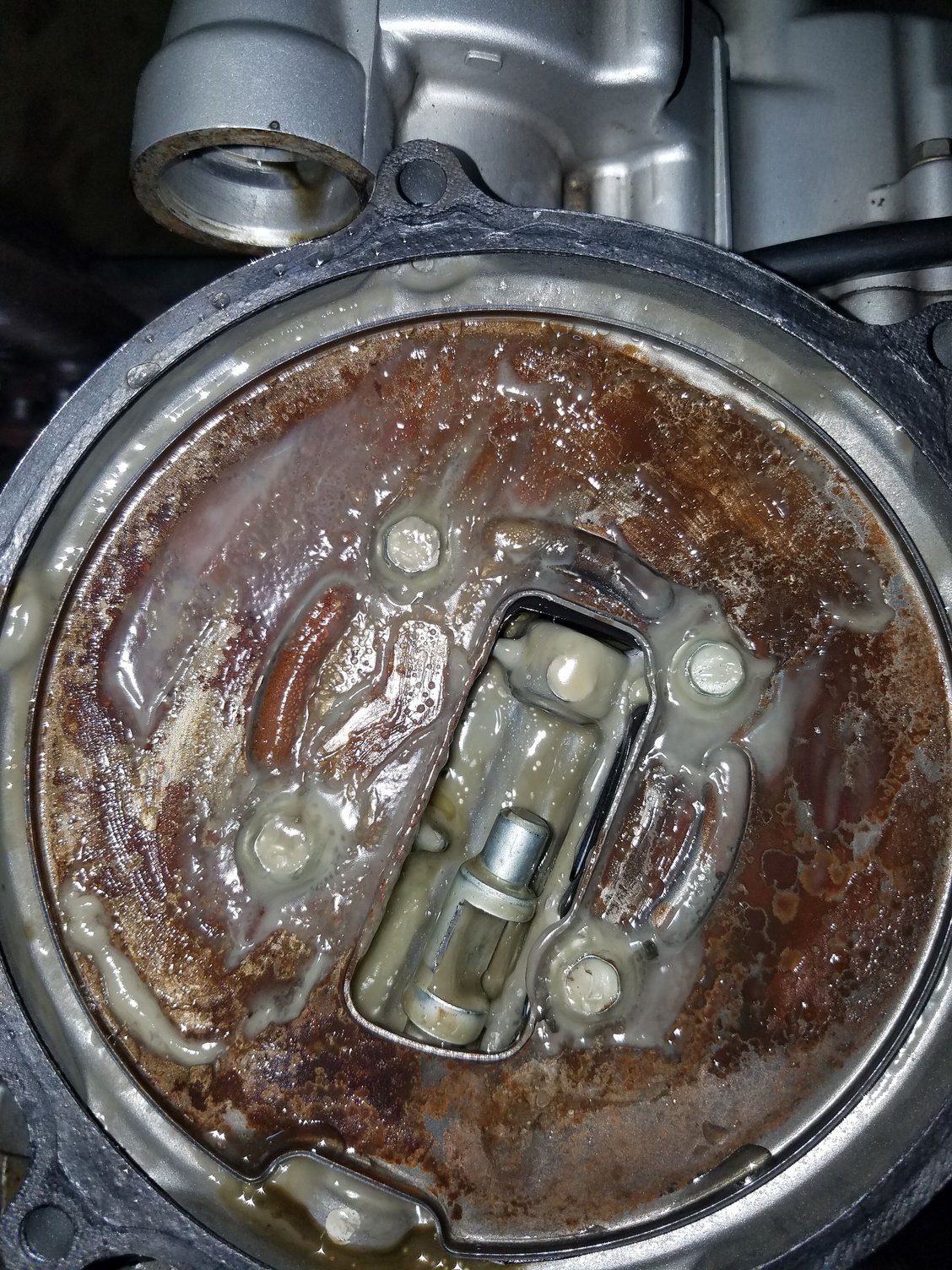

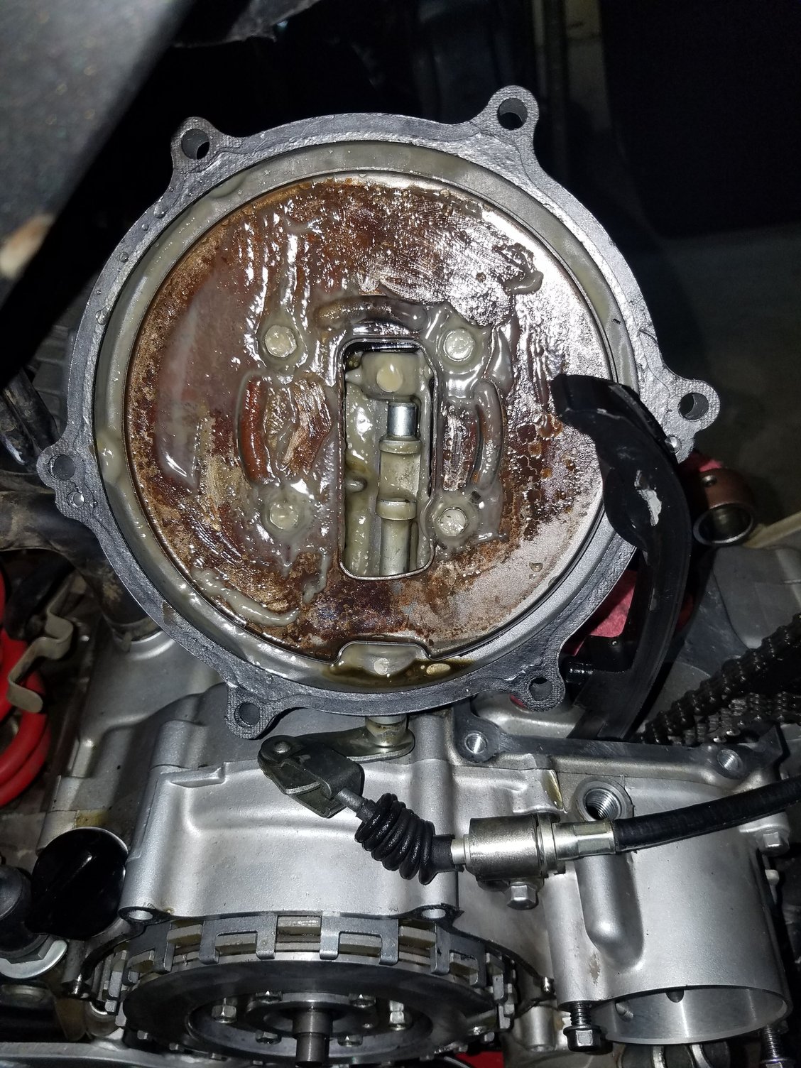

Ok folks...
So I am doing a tear-down rebuild on a second hand KLX250sf...I'm re-doing the BB351 as it had some pretty heavy carbon build up and scoring, so I decided to go ahead and do the Barnett Spring replacement.
Once I got the oil out...which looked fine...I popped the clutch cover off and found this.
It seems like it is some kind of thin snotty grease...it's not the normal oil/water choco-milk. Assembly lube? I don't think that should be in there??
Thoughts?

Originally Posted by durielk
Is the clutch haunted, it looks like you need 'ghost buster' treatment.
Snort....or maybe in a "Adult Situation".
I am worried there is a coolant leak, but I didn't do the original tear-down of the bike. I mostly mess with air-head boxer motors, so this Liquid Cooled voodoo is new to me.
Again, the oil from the sump looked ok, the only place I am finding this is inside the clutch cover so far.
