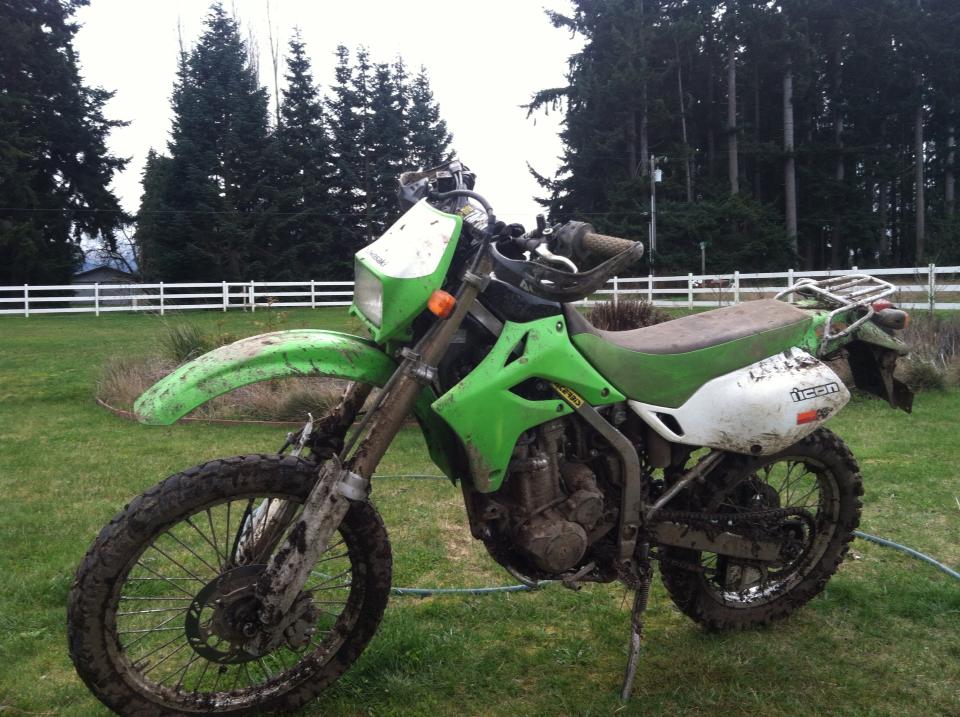

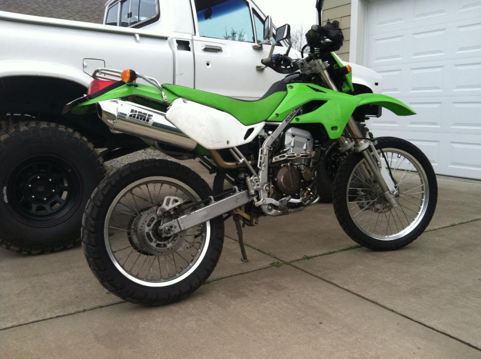

Picked up this 06 last summer for $2500 all stock with 4000k miles on it . Since then i have put an HMF pipe, K&N filter and jetted it .
I have a few questions reguarding gearing and chain length. Currently been running a 13/42 set up for trails and a 15/42 when i ride the road and the 106 link chain has worked good .
I want to run a 15/39 for road but i need to figure out chain length. I have found on here once that someone was running a 104 link chain with this set up. Can anyone confirm
I am running a set of Shinko trailmasters 120/80/18 rears and a 90/90/21 up front
Also for trail riding i want to run a 13/47 or a 13/45 because right now with the 13/42 first gear seems to low but second is two high
Can anyone confirm chain leath on a 13/47 (108) links?
I am a whole 135-140 pounds so i think ill be able to pull of the 15/39 just fine, any input would be nice THANKS!
