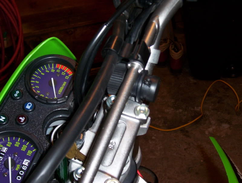

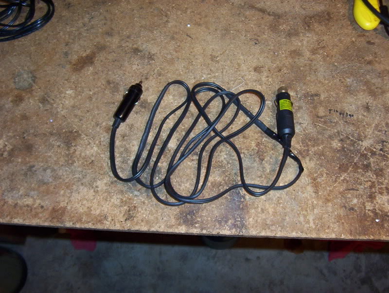

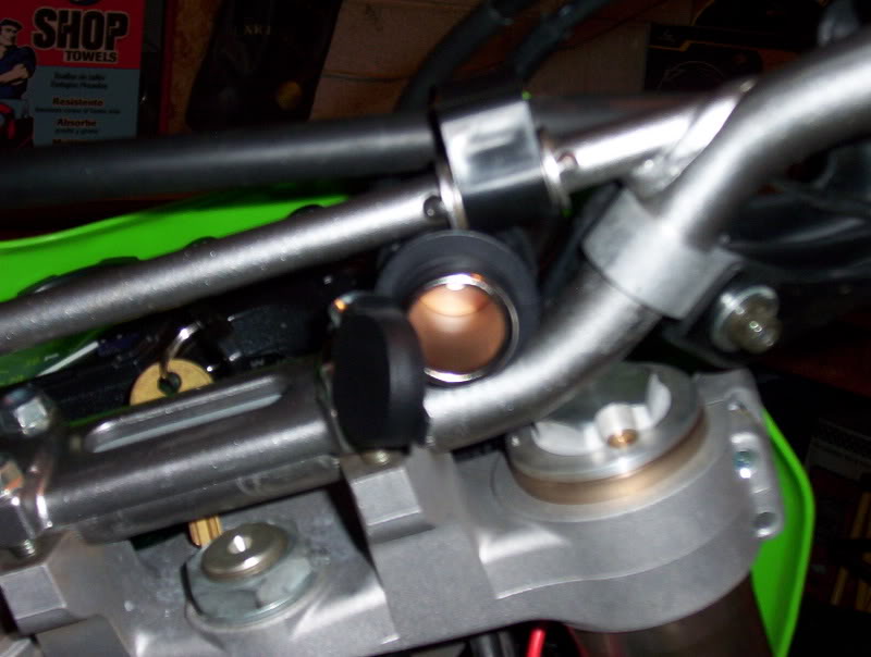

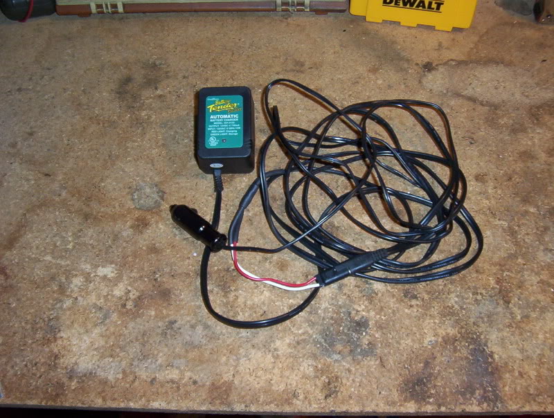

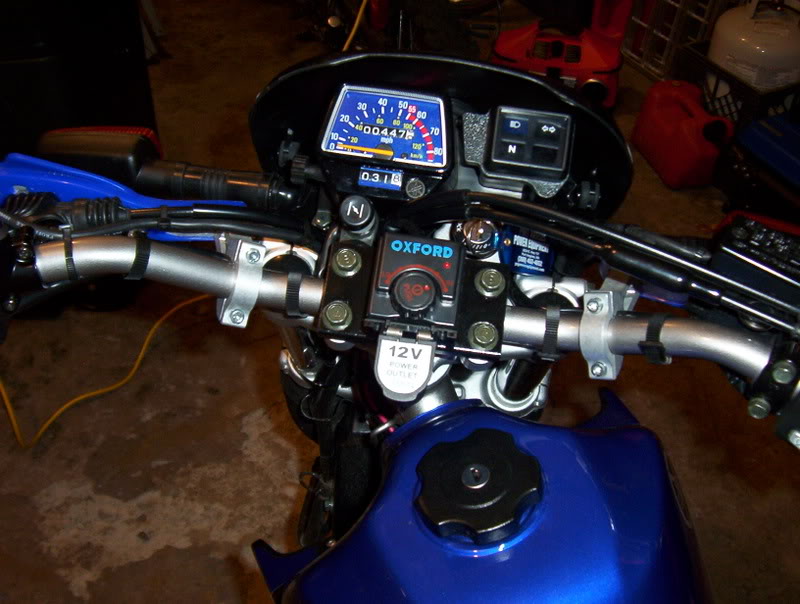

Yes you can, just run a black and red wire straight to the battery like I did. It makes it nice to be able to charge the battery, run a cell phone, jump between bikes.
