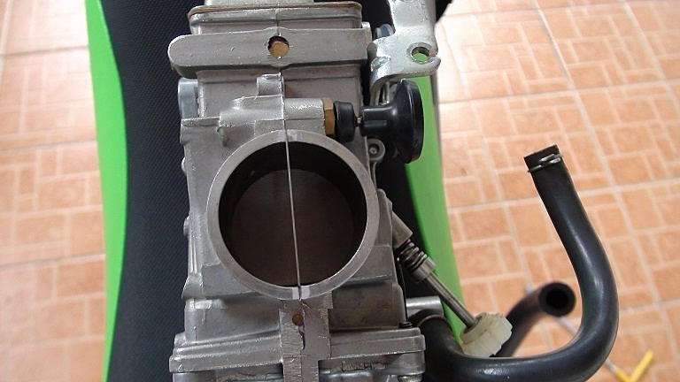

I did this to my TM36 a few weeks ago after apparent success with a similar mod to the intake manifold of my XR200, and if the SOTP results match timed video testing when I get my camera in position, I'll have to try it on the 40mm..
I was neutral to pessimistic as I road out to test it first riding the XR200 with its new Webcam, then 2 weeks later on the KLX. If anything I was just hoping the mod would make either bike a kind of wheelie machine and was very surprised when though the wheelies weren't any easier...instead both bikes crossed the finish line of my 1/8 mile test straight (highway) hurtling along at what seemed to be faster than previous speeds, with the Kaw well into 6th gear and still pulling strong on the slight uphill grade. (14/48)
I guess I shouldn't have been surprised at the Kaw's response since the XR seemed to like it, but a couple weeks had passed and the clear memory of the XR's torquey ride had faded to uncertainty as to whether it'd made as much difference to the XR as I thought.
My Kaw speedo wasn't working at the time, but it is now, so soon - along with everything else I want to test I need to confirm what felt like a nice big fattening of torque under the curve for both bikes. I just remember coming away from both rides (weeks apart) with a sense of "whatever it was that just happened - it felt GREAT!"
It's just a .5mm thick section of 1/2" wide pocket rule notched to only require cutting into the carb 1/4" top and bottom covered nicely by the intake manifold's rubber.

- After getting apparent success with the added intake divider on both bikes I felt that was enough testing for awhile and focused on getting my O2 sensor bung welded in and other things that don't involve beating on the bikes
