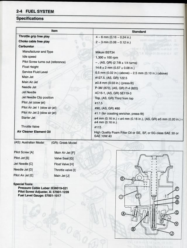

I have a 2000 KL250 and i have been messing with and i don't remember what the stock main jet was or if the needle had washers or not.
My friend was the first owner and he told me what he changed but i have not been able to find my paper work,I have 3 bike that i cant keep my fingers out of,its kind of like a new girlfriend,hehe

Super Sherpa

Thanks, Silver_Otter
