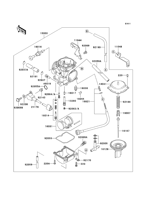

You will have to take the float bowl off again. Sounds like there is something (a grain of dirt / sand will do it) blocking thefloat valveopen (16030 in the pic) and therefore the fuel is flowing out the overflow. Either that or youaccidentally adjusted the float.
