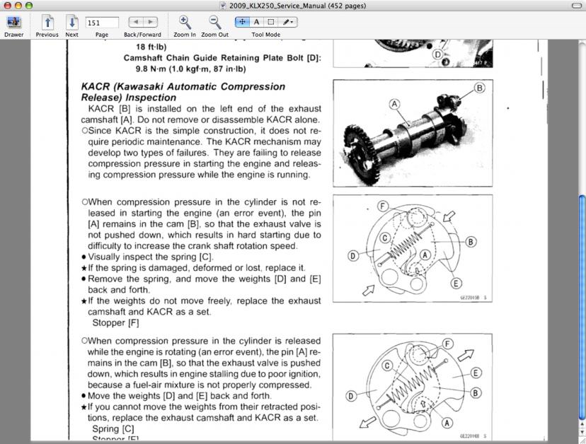

Sounds like a problem with the pin!
This may help.
Attached Thumbnails Can anyone tell me if my compression releaser is broke?! (video)-snapshot-2009-06-14-09-20-49.jpg

Originally Posted by Brewster
That clicking seems to coincide with the closing of the exhaust valve. When the tab on the ACR gets past the top of the valve bucket, the exhaust valve closes........When held open by the ACR, it is open by about 1.5mm or .06".
That could be right.
I'm trying to think it through.
Maybe that click is the normal operation of the ACR at low rpm?
mmmm
I didn't hear a click but I didn't remove the cam cover.
