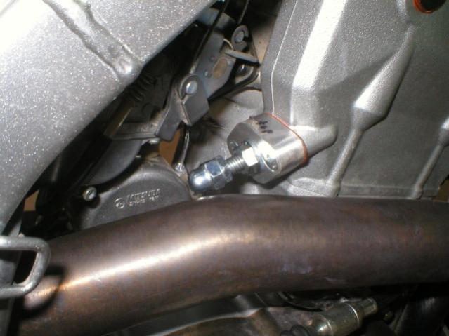

I've mounted and ridden with this tensioner now, and it was simple enough. Initially the mounting of the tensioner with my fat, Muzzy header was a bit challenging until I figured out how to access the inside allen bolt. I used a 3/8 ratchet with a pair of just right length exensions which made tightening the inside allen easy. The outside allen bolt was easy to get to.
I trimmed the length on the threaded plunger rod which made accessing the acorn nut on the adjuster easier. Due to its proximity to the header pipe, I once again resorted to the 3/8 extensions with a 13mm socket. You still just use the finger tight method to screw in and/or back out the adjuster rod as you listen for the timing chain to rattle...turning in the adjuster until until it just goes silent. Hold the acorn nut with a wrench and then tighten the locknut, and you're good to go.
The tensioner is simple and straightforward. The access to bolting up the tensioner is easy once you identify what extensions or combination of socket and extensions will work. It required a 4mm allen 3/8 socket which is easy to obtain if you don't already have one. The best reason for using the countersunk 4mm mounting bolts is the ease of accessing the lock nut. Even 8mm head bolts will be in the way. Once you bolt up the tensioner body, you're not going to be messing with it anymore, so those 4mm allen bolts are worth the extra trouble of initial installation. And like I said, once I figured out what length extensions were needed, I accessed that hard-to-get-to inside allen bolt with a 3/8 ratchet from under the airbox...a nice straight shot. The reason I use a similar setup of extensions to access the acorn adjusting nut is the heat off the exhaust. The 3/8 extensions extend to the open area under the airbox where you turn the adjuster rod in and out without risk of burning your hand.

The adjuster bolt will be shortened according to TNC's experience if/when these are made. The part is asymmetric so there is a top and bottom as you may note by the high tech Sharpie note - not sure what to do there, maybe some indicator arrow. We are working out the instruction process, as TNC has performed adjustments. Cost is going to be tied to interest, small numbers would push it up higher than the others I've made. As it is the price should be $30 plus USPS Flat Rate Priority shipping, $4.95 in the U.S., $11.45 in Canada, and $13.45 for the rest of the world if a fair number of parts are cut.

Ill take one probably two without the countersunk mounting holes. Would pay bit more to have the outboard sholder milled down 4-5mm so I can use the stock style bolts and still access the lock nut.
I looked at TNC's photo and at my bike and it seems I have a lot more clearence on the headder. I have assumed my headder is a muzzy becuase its definatly way fatter than stock but mine has mounts for & a heat guard which I dont see in the photos.
TNC does your muzzy header have a heat guard?

MITS...no heat guard on mine. The pipe was purchased no later than '07, so as Red points out if later models had a guard, mine isn't one of those. If Mark is going to use normal bolts with a head, it's going to require more complex machining. I will say this was a concern of mine, but once I figured out an easy way to access that inner bolt, it's not a big deal to use the countersunk allens. Once installed it's pretty much there for the duration.

I got some feedback from TNC that it might be questionable if the flange bolts can be used, I will take a look when I get them cut. The cut out for the flange might interfere with the lock nut flange due to the offset of the adjuster bolt. I will have to look. I will say I have no idea what it might add to costs due to having to have it set up and milled, but I will see if there's a way to do it at significantly lower cost than that. Part of the reason for low pricing is innovative cut and finishing. The other part might be foolishness on my part, but what the heck...
