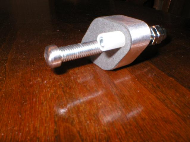

I got the manual tensioner from Kreiger and will install it today. It's technically a prototype, but it will probably be the final product if no issues are present. I should know fairly quickly. While not rocket science, everything has to line up properly, of course. I'm looking forward to having a tensioner that will work no matter what.

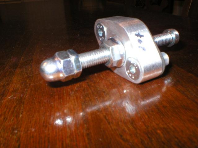

Looks pretty clean but I think I would rather have teh two bolts that hold it in be hex head like the oem tensioner than countersunk allen head. Seems like it would be more of a PIA to remove the rear one and more potential for buggering up the inside if the bolt seizes up a little over time. Whats the size of the allen wrench for them? Looks to be about 4mm. I know that on the compressors I work on there is more potential for damage to tool or bolt on a 5mm allen than a 6mm. I have had to do battle with stuck and stripped bolts and avoid it whenever possible. (Thats why I got rid of the allen bolts in the Nomad rack.

I am a member here and I can fill you in a bit on the tensioners. I am definitely anxiously anticipating feedback from TNC. We spent a fair amount of time on getting this right. Two were hand cut then I found the plungers were located in the wrong position. So on the remake I actually got them cut in my normal production process. It is essentially exactly what will be made if all works as expected.
The bolts are countersunk for a few reasons.
One is to keep the lock nut totally open for a wrench.
Two is that I do not like the "pre-rounded" Kawasaki bolts and with the way the tensioner fits the head, angled downward, I don't anticipate too much issue with the zinc coated fasteners. But that can be dealt with.
Three - aesthetically they just look professional.
The kit is made the way I wanted one, back when I started making them for the KLX650 and Zephyr 550/750 when no one would list or make them. It has everything needed for the conversion without a visit to a dealer.
I've run a manual tensioner for over 28,000 miles in the KLX650, having made 4 adjustments (less than one full turn of the bolt, in total less than 1/16" movement) in that time, and now about 8000 miles in the Zephyr with no adjustment yet. I only removed the original manual conversion in my KLX to run my first 650 tensioner before I sold the second one, otherwise it would not have been taken out. The Zephyr ran the first one of those I made, before one was sent out too. Oh, it should be mentioned I had to do a top end to put in new chains (2 in the KLX) because I believed it when people on the forums said they were all noisy and it was normal. I put in a new OEM "automatic" tensioner at 5000 and rebuilt after the second "automatic" tensioner failed by 15,000 miles. When the same was said about the Zephyr, I knew I wasn't buying that. Now both the Concours and Eliminator groups, where the same is said and it apparently is common practice to have to pull supposedly "automatic" tensioners for cleaning and resetting, are discovering the same tensioner that fit the KLX650 fits their bikes and are in touch.
If the tensioner does the job as expected for TNC it will become available.
I've shipped to 15 countries including of course the U.S. and Canada by U.S.P.S. flat rate Priority. A few of the more interesting were Latvia for a KLX650, Poland for a Zephyr, and Malaysia for a KLX650.
A special order without the countersink fasteners can be done if someone requests it. I don't carry any bolts like the stock ones, so the fasteners wouldn't be included in that case. I just have a liking to the clean look and accessability.
Because Kawasaki used an O-ring instead of a gasket, special gaskets were laser cut and two extra will be sent with the tensioner in addition to the one on it.
If it works as expected, I can be PM'd or emailed from here for more details.

On the KLX250/300 manual tensioner, I'm in touch with Mark Kreiger about shortening the exterior portion of the threaded plunger. It's a little too long as delivered on this prototype, but if he gives the OK, I'll cut it down. My Muzzy head pipe is fat and interferes with the adjusting acorn nut.
