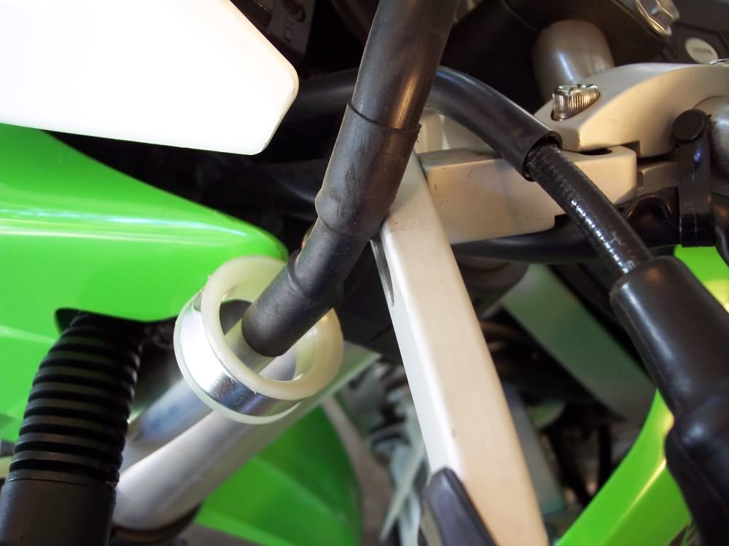

SPEEDO CABLE: It looks like you need to do like we did... loosen up and rotate that plastic ring hose router thingie on the bike, and spin it forward so the cable goes outside of the handguards. Something like this, maybe:
The clutch cable willl rub against the bracket of the handguards but you can just wrap it with tape like you did with that other one. That's what I did.
