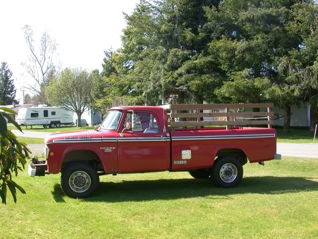

Oh I just remembered something, back in the day I had a 73 Datsun pickup that would do the same thing, but it would just die on the way to work, I would pull over and wait a minute or two and then it would be fine, I finally figured out what it was, the heat tube from the manifold had worked loose causing the carb to ice up. I also had about 5 years ago a 1967 Dodge W200 4X4 Power Wagon that would do the same thing, I could actually watch the carb freeze until the engine got hot enough to maintain a high enough temperature to run. So I know about icing, and will be watching for that on the bike. Oh and hereis a picture of the truck,....I should have never sold her........

Sorry the picture was a little wide.[:-]
