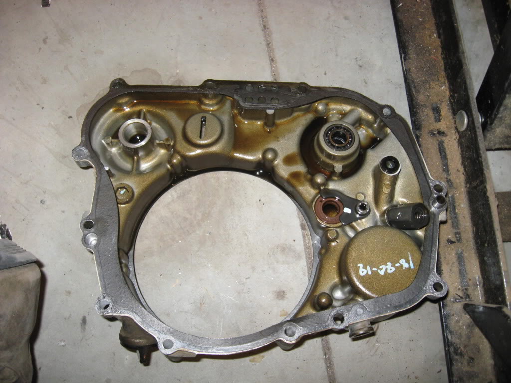

check my 351 thread https://www.kawasakiforums.com/forum...351-0-a-36944/ for pics of the other side of the site glass. I looked at that when I had it apart and just figured it would be a press out / press in fit. PM me your private email if you want a copy of the manual. Let us know how this one turns out.
edit - here's one pic:

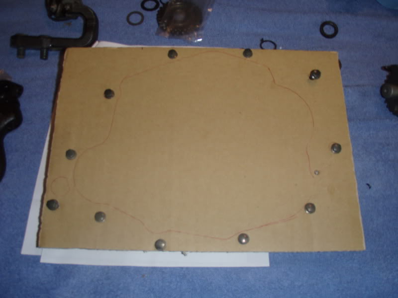

PROTIP: some are different lengths. To not get messed up, take a piece of cardboard and sketch the case cover and put dots for each bolt. Then as you take off the bolts, stick them into your cardboard sketch in the right spots.
Once you have the case cover off, the sight glass is held on by one bolt I believe. Swap, put it back together and ride.
Someone verify I haven't missed a step, I forget things often
Yep good call, that's what I did when I installed the kick starter on the wife's bike.
