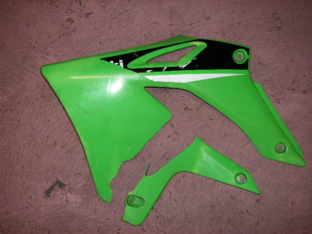

Well I busted my left radiator shroud and Kawasaki want a ridiculous amount of money for a new one.
Any way, a few rivets and some scrap aluminium.
Job done.

Nice fix. When I busted my handguards, I used super Glue and then ran my soldering iron down the inside of the crack "fusing" the plastic back together. I love to solder plastic this way. It is almost invisible from the outside.

Nice fix. Looks a lot better then the lace jobs I have seen done with zip ties.
