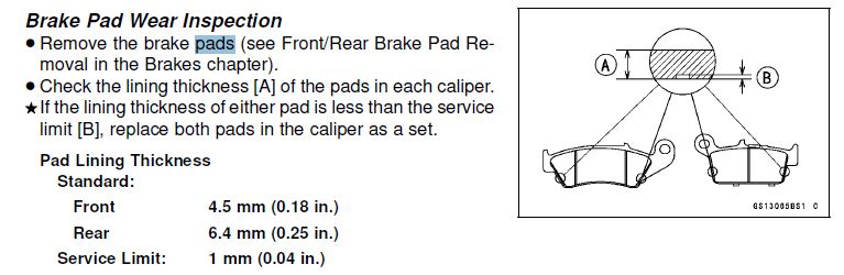

I'm not quite at the service limit based on this downloaded 2011 revision service manual so no decisions yet... Which is good because I just spent my leftover lunch money on a Sargent seat.

what are they using to measuring the thickness of the brake pad? a digital caliper? 1mm seems really thin......
I would like to change the brakes just because I like doing stuff like that,
but wont until they really need changed.
I havent noticed decreased braking because of the pads, but will eventually have to replace them. most likely with OEM because they seem to last the longest.
