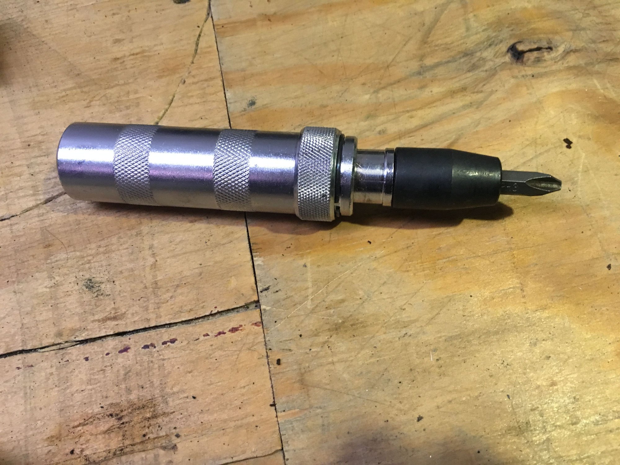

Impact screwdriver, my new favorite tool.

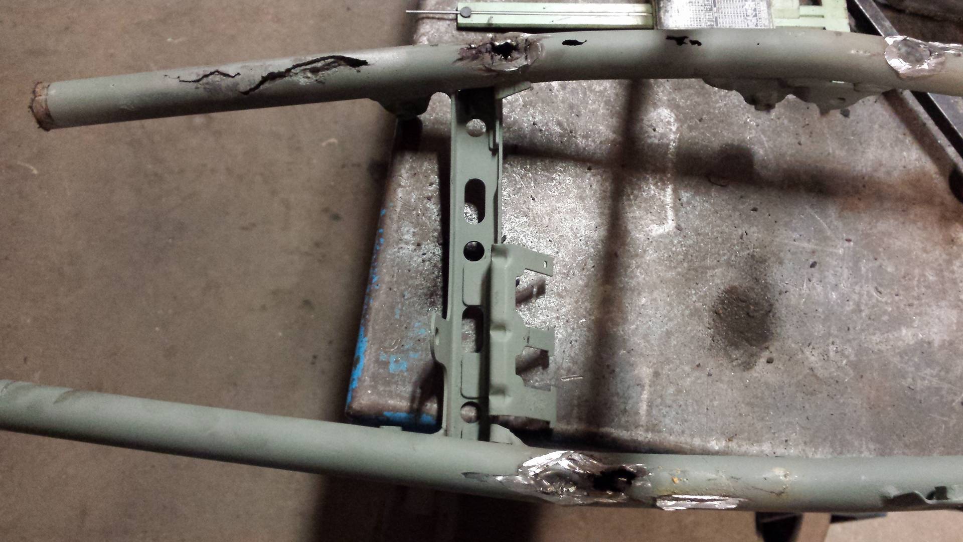

Not much to report on the motor front yet...been laid out with a bad back for a week due to wiping out on my glacial like property.
But I just got a frame update from my buddy. I somehow knew he would do more than repair it...
It's serious now.
Ain't no going back. That's gonna leave a mark The garbage.
The start of a beautiful relationship.

Frame is done!!!
Old section used as a template.
Almost there.
Finished!!!

Looks great, cutting off/rewelding all those tabs/mounts must of been tedious
