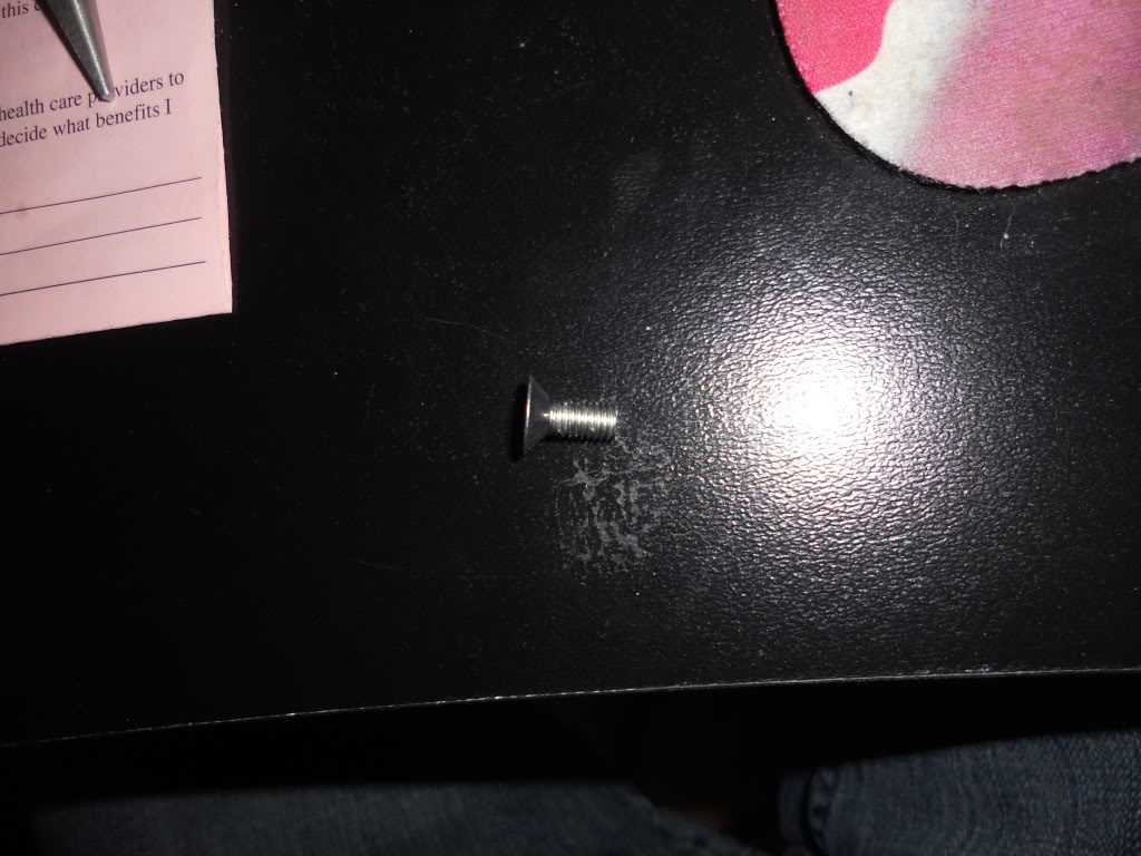

And I need a replacement screw for the throttle cable bracket, It's a philips head about 3/8ths of an inch long. Removing the bracket makes carb install a breaze.

Have you seen this screw? I've been trying to get this carb to work for over TWO years.
I'm looking for Bill's help.

I'm familiar w/hex heads. But haven't seen one that is tapered to fit the corresponding taper on the bracket.

Is it like this one? This particular one happens to be from my TM36-68, and it's a JIS machine screw, M5x12 as close as I can measure with the scale on my leatherman. If you have a TM33, I don't know if the screw is exactly the same. Or are you talking about something totally different?
Now I understand: this one most likely is not at just any local hardware store - I was thinking, like Dan probably was that it was the same kind of generic screw as on the CVK. But if this is the type of screw you're looking for, you could order off of McMaster Carr and probably have it on Monday - not the cheapest way to go, but you can get it in a hurry. This is the catalog print from McMaster for an M5x10 version, including the part number.

That "looks" just like it. Sure hope your correct.
I ordered 25 anyone else need 20? ( minimum # ) Nyuck Nyuck Nyuck
