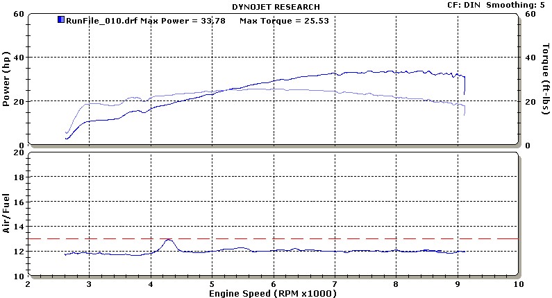

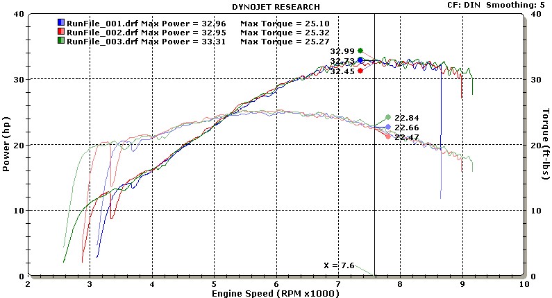

Here is my 351 with his 34mm carb, #101 Web cam, port & polished, FMF bomb and 2B M-7 silencer. I also had smooth tires which helped get the power to the dyno, I think most have been with stock tires?
Either way a big bore kit for a stocker is the best bang for the buck!
