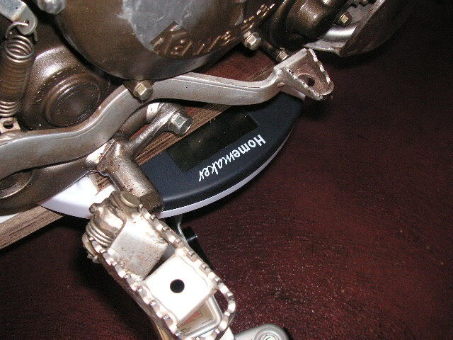

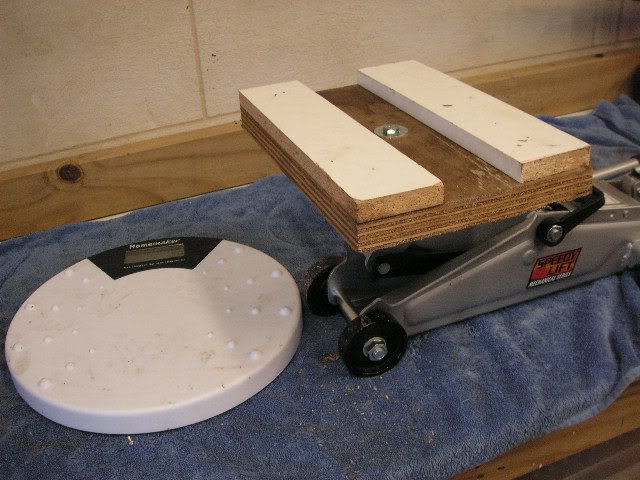

I bolted a wooden plate to a trolley jack.
Put on the scales and another piece of wood and bingo.
I weighed the bike 3 times and each time got the same reading.
125.7 Kgs
276.5 lbs
You can just make out the digits.
That is with no fuel and tools/spares removed.
(oil and water left as is)
I believe this to be reasonably accurate as when I weighed myself with this set up I got the same disappointing number I always get.
I also checked the scales to see if weight distribution made any significant change in the final number, and it didn't.
I wish I had done this on day 1 so i would have a reference point.
