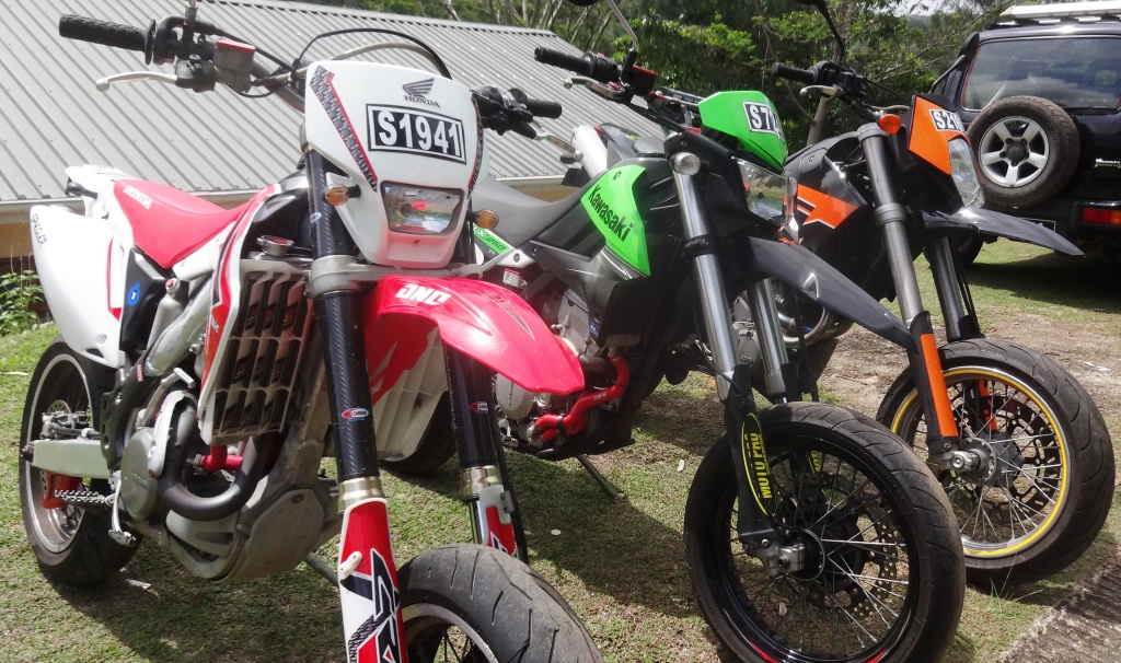

Yes it is a pity. The EJK only really makes a big difference on the 300/331/351 big bores, where it will not run without one.
The only way really to get some grunt out of the EFI bikes is with a Big Bore. Then they really come alive!
On the 250 you really need to go all the way with air filter, backfire screen, second butterfly, header and tailpipe. All unfortunately big money for small gains. I spent a bomb on my little Kawasaki looking for ponies.
Now to get real horsepower that makes my teeth bleed, for small money, I bought low mileage second hand race machines from guys needing money, so it does not matter anymore that my beloved Kawasaki is light in the pants.
