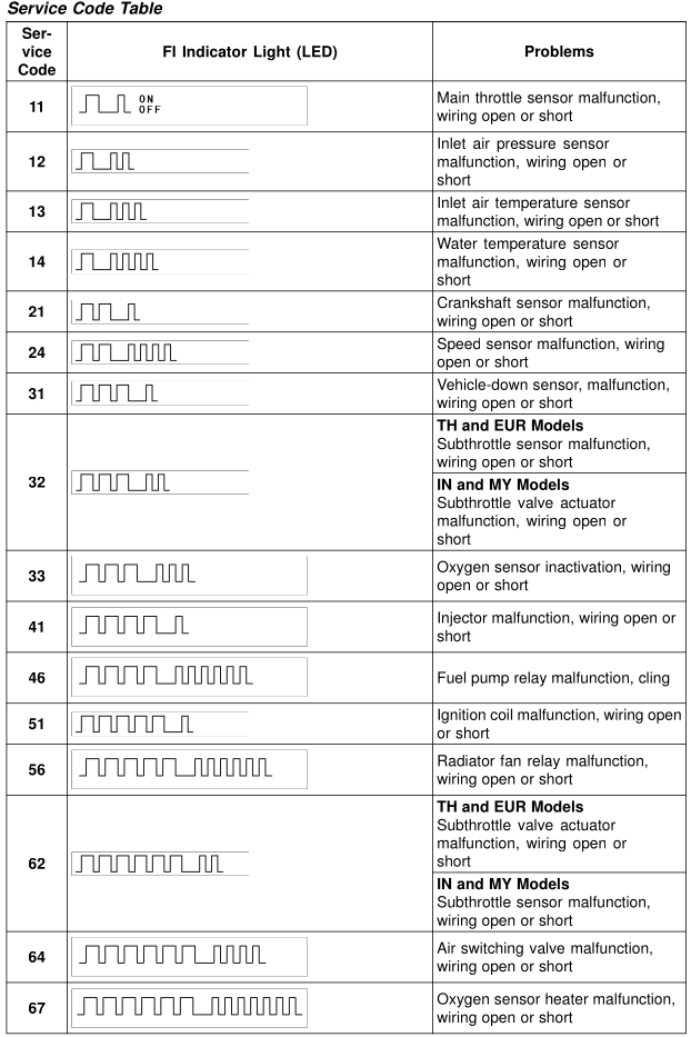

Default fi light pops up when kill bike, won稚 start till i turn key off and on
Hey guys i知 not sure how make my own post so i知 just replying to this one but.. I知 having a problem when I start my bike and ride it for however long then kill it with the switch the red Fi light comes on and when i go to start it back up it just seems to crank. Then I turn the key off and on the bike fires right up but has a low idle. It is a 2019 klx250. it has an ejk and fmf q4 on it. Could it be a problem with the EJK??
SOS!! any help would be greatly appreciate

Use "Fuel system (DFI) > Self-Dianostic" from service manual to get error code. Maybe it's not EJK related.

It's simple to get code - you need find free 1 pin bullet connector at orange with black line wire under seat or right seat cover.Then you need connet it's to ground (battery negative) at "off" key position.
After "on" key position and "FI" light will blink for code.
Then you need to comapre code with table to catch mailfinction
