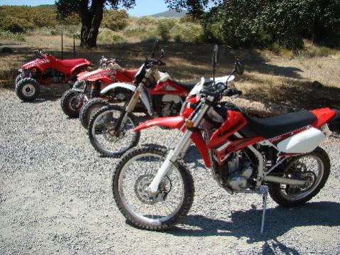

Well now that the rings have been seated in, pinning the throttle happens occasionally. but now that has a unfortunate side effect..... signs of a slipping clutch. I change the oil & filter at the same time as the husky. That means way soon for the maintenance schedule of the kawi manual. Probably changed the oil/filter 7 times in 1300+ miles (3 times in the first 250 mi.). Husky gets spectro & klx350 gets maxima/fram 6015.
Any stronger clutch springs suggested that can be swapped in? I remember running cr500 springs in the 250r
