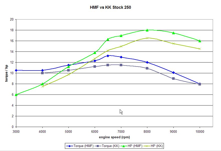

Old Mar 1, 2012 | 06:21 PM
  #67
IDRIDR's Avatar
Posts: 4,507
From: SW Idaho
Default Stock KLX250 Dyno Curves
As an example of how different bikes of the same make/model, different dynos, different days, etc., here is a chart showing the torque and hp curves from the HMF dyno chart on a stock KLX250, and the Kustom Kraft dyno chart on "old hp" as it was labeled on the chart. I don't know if the Kustom Kraft measurements were on a fairly fresh, well tuned KLX without any mods, some mods, worn out, or ??. So the comparison is probably not the best, but it is something.

Old Mar 1, 2012 | 08:02 PM
  #69
2veedubs's Avatar
Joined: Feb 2011
Posts: 628
From: Northern Kettle Moraine
Now that you mention it that KK stock dyno does look a couple HP low. 18 is a fairly common HP figure thrown around here for a stock bike.
Old Mar 1, 2012 | 08:43 PM
  #70
TNC's Avatar
Posts: 5,050
From: Abilene, TX
In reality the dyno is better used to show the difference in a before-and-after scenario rather than compare power results from dyno to dyno. In that area they are a good comparison tool. Even then, the way the vehicle and dyno are operated, the atmospheric conditions, and a host of other factors have to be the same.
You know what?...the butt dyno is starting to look pretty darned good right now.
And seriously, it's sometimes more important when and where the power is occuring than the peak power created. The driveability and trailability of a dirt bike can be improved greatly without a lot of peak power gains if it's done right. But I think most of us know that already.
