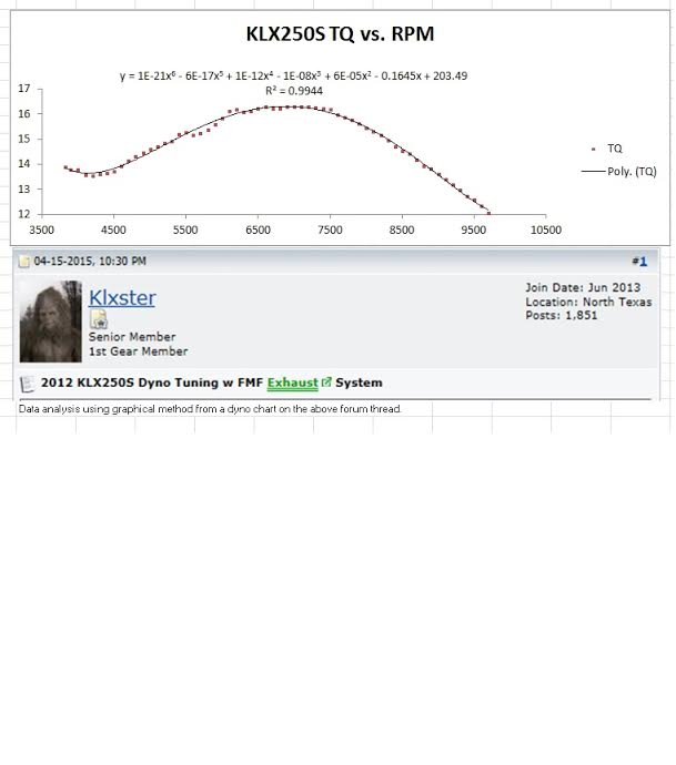

Put the files in drop-box or google docs and send me a link. I managed to graphically lift the rpm vs TQ data from one of klxster's dyno chart images using autocad. It was slightly tedious but the data was usable, except I only used data at each 100rpm to make the whole process tolerable. I have managed to analyze rear wheel thrust with the data for each gear and approximate coefficients of aero drag, wheel rolling resistance, and frontal area such that the calculated top speed was reasonably close to the speed I get on my bike: 83 mph on flat road zero wind. While the numbers may be "right" or "wrong", the effort will give insight as to the effect that changing one of the variables will have on bike performance. Now that I have gotten down to a table of mph vs. net external forces I should be able to calculate acceleration for each gear. If I integrate the regression fit of the acceleration curve calculated from the net force data I should be able to get a velocity curve. Then if we set the shift point around to RPM acceleration drops off we should get the approximate best acceleration of the bike/rider combo rowing through the gear box. One problem may be in switching from a rpm domain function to a time domain function. I have yet to think on it. Too much fun.

Holy Crap, seems you can quantify the rider experience - given a set of performance mods and the attending data !!!!
I'll get some "Dyno data files" setup for your perusal at my earliest convenience..
