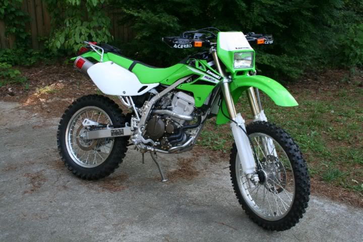

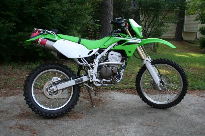

You guys started making me feel like I was missing out on something by posting all your mods and how well you liked your bikes now so I had to go out and get some for myself. I really hated how the bike had no low end torque in the woods - making me rev the **** out of it to get up what I would consider a moderate hill and the stock tires SUCK in the woods, in my opinion. So - I wanted some sprockets and new tires and some how the want list blew up and I went a little overboard. Can't say I regret it, the bike is freaking awesome now. Like night and day. After seeing that thread about supermotos - I'm thinking I might want to get a set of supermoto wheels/tire next so I can't swap them out when I want to ride it on the road.
full Big Gun EVO exhaust
125 main jet
2.0 fuel screw
40 pilot
shim needle .032
front/rear sprockets (13T fr - can't remember the rear)
Pirelli tires (front 90/90-21/rear 110/100-18)
MSR bars
Acerbis handguards w/blinkers
low profile blinkers in rear

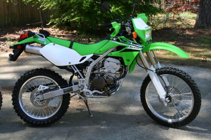

Before - the day I bought it.
As it looks today ... w/few mods.

[sm=smiley20.gif] Looks great Bonafide. Which Pirellis are those? They look extremely aggressive..are they 10% road, 90% off? How do they handle on the road? My back tire is about shot, and I'm trying to decide what too go with. Also, what bend did you go with on the bars? I'm done with the questions now..WAIT! One more..isn't that a Cobra I see in your garage?[sm=gears.gif]
Thanks Dave!
The rear is a MT32. The front is a Scorpion. They're pretty soft and are what I would call "squiggly" on the road. Not sure I would recommend these for the street. I don't ride on the road with my bike at all right now. If I do, I'll get a second set of rims for a supermoto set up - and switch them out when needed. As for the MSR bar - I have no idea. Seems low and wide - but I needed to use them if I wanted to use the acerbis handguards. The local shop picked them out for me. I'm going to try them this coming weekend, but I'm thinking I'll want something with a higher bend - I prefer to stand most of them time while I'm in the woods.
