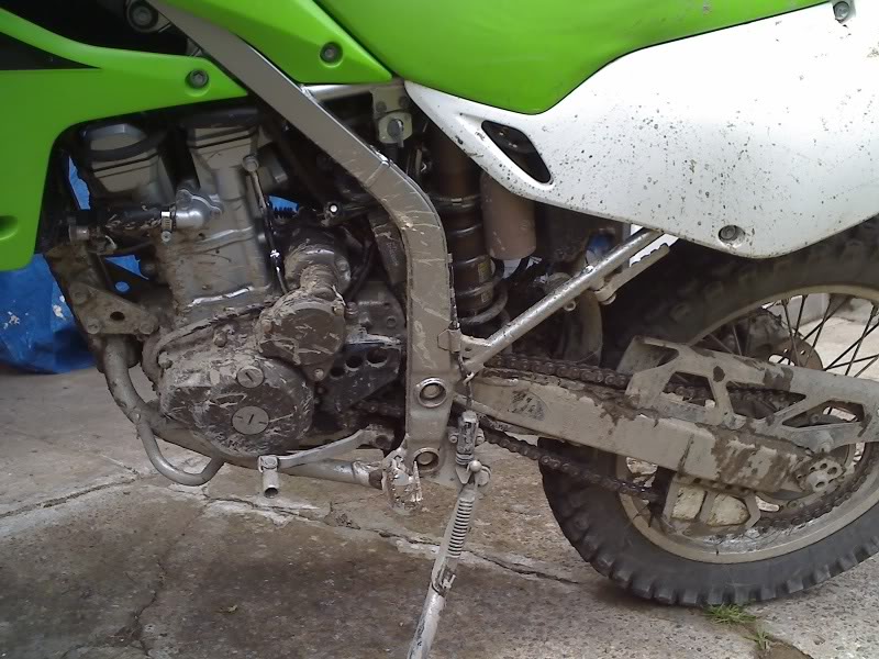

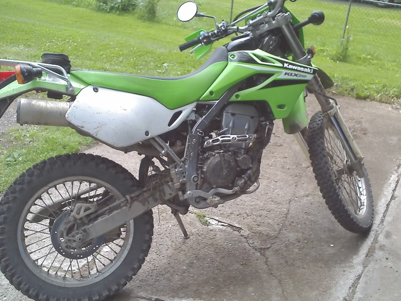

This has got to be one of the best products to really help clean up the KLX after a good ride through the woods. It is practically rinse, spray and soak, then rinse off for clean look. Didn't really need a sponge to do any cleaning. So for those of you who don't know, the product I'm talking about is Simple Green.
The before shots:
Light enchanced to show more of the dirt

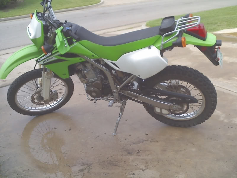

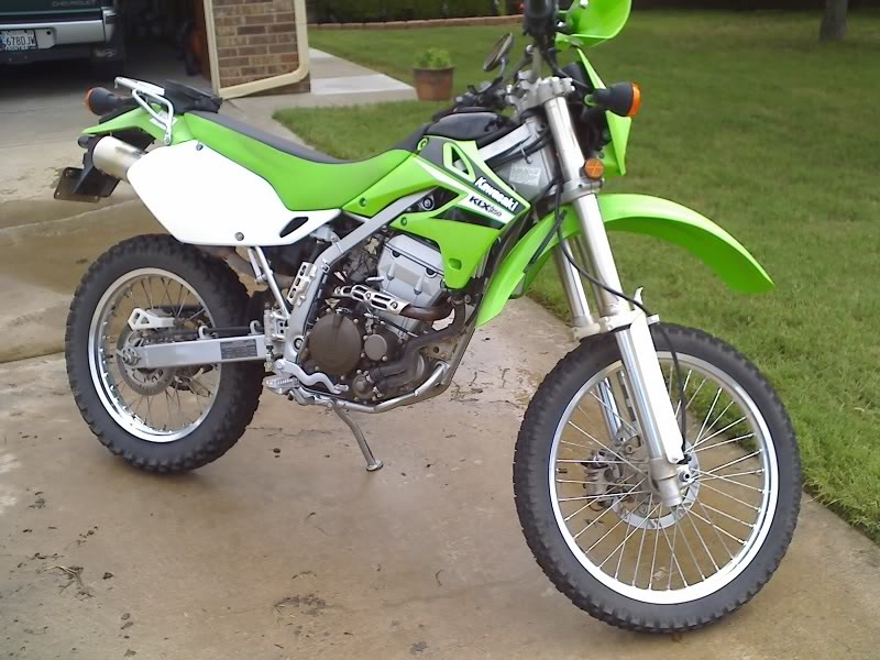

The after clean shots:
Light enchanced to show more of the cleanness.
All I did was rinse off the mud first. Spray on and let it soak in. Then rinse off. I only used the sponge for the plastics and seat. I also mix it at a ratio of 1:1. Or 16oz to a 32oz spray bottle.

I'm a fan of simple greeen, but not on my bike. It cleans a variety of things really well....HOWEVER, it's highly corrosive to alluminum and alluminum alloys, so if you have to use the stuff rinse it off immediately and thoroughly. Letting it soak-in is not a good idea.
Here's some findings from a study USAF did on the stuff back in 89. When I was in the USN, we were told to stop washing hanger bay floors with Simple Green while aircraft were inside because its was corroding the wheels.
http://www.bikeforums.net/archive/index.php/t-4117.html
Air Force, results from which were published in 1989,
> aluminum alloy samples were immersed in Simple Green for
> a week then removed, cleaned and weighed. The results
> indicated that the approximately 3.5-gram aluminum alloy
> samples experienced a material loss of about 31 milligrams
> in a diluted solution and a whopping 295 milligram loss
> after spending a week in the undiluted liquid. The Air
> Force report summed it up this way: "We do not recommend
> the use of this product on Air Force equipment containing
> aluminum." Good advice, that.
I know you like to play devil's advocate, LeerJet, so don't take my word on it. Do a search for 'simple green on aluminum' and see what pops-up.
