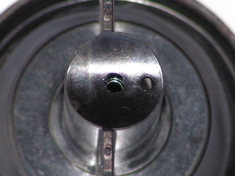

after lookin thru the "mod day" post and studying up a bit i was wondering if
any one has a picture of what you drill in the carb w/ 7/64th bit? i havent really played around with that side of the carb yet... i just got all my gets and the nt1c needle, clip, coller, 128,125 #40 and am not really sure where to put the clip... 2nd ring from the needle end or 2nd ring from the short end?? very minimal mods... cc, k&n, drilled stock exhaust

The one on the right dude!

In the case of the KLX, Kawasaki chose to limit the carb opening by drilling two holes near the top of the slide. This has the effect of reducing the vacuum that pulls the slide open. The quick fix is to fill the holes with epoxy.

And something else to keep in mind when putting the needle and plastic collar back in is to make sure the feet on the plastic do not cover the hole!!! someone mentioned thata while ago and it stuck with me when i did mine..very good thought!..you'll see what I mean if you look when putting it back together.

"In standard from the KLX is heavily restricted, so here's the hot set up to make the bike perform in the manner it was supposed to. First of all pull the carburettor slide out and fill the two holes drilled in the top with epoxy resin or similar and smooth off so that it doesn't snag in the body. Alternatively fit a new slide without holes, Kawasaki part #161261382. Remove the airbox snorkel and the spark arrestor in the end of the exhaust. Finally, go up three teeth on the rear sprocket. The result is an extra seven PS and more power everywhere. Sorted!"
