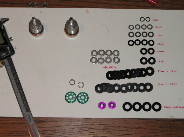

I spent last Sunday doing the compression valves on my bike and took a few pictures to add to this thread to make it easier for the next guy.
I laid out all the parts and labeled them so that people know what we are talking about.

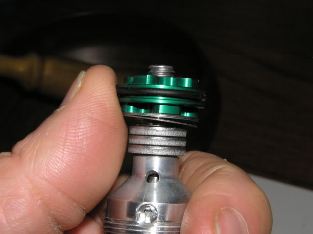

Here is a shot of the compression valve with three spacers on.

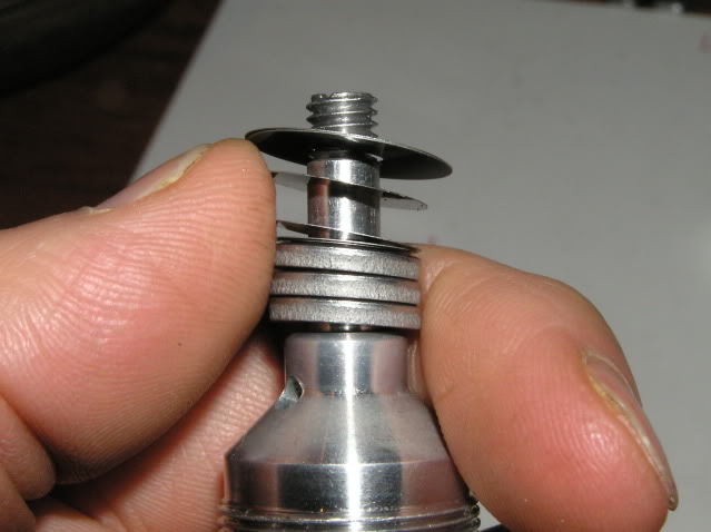

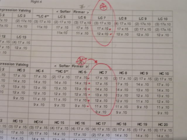

This is the valving sheet that you work from to get the stack of shims for your particular weight, riding style etc. There is a high speed and a low speed stack of shims that you load onto the compression valve in reverse order from the sheet,

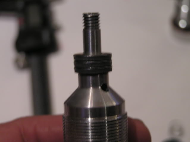

You start with the high speed stack first working from the bottom of the chart.
You work your way smallest diameter to largest through the high speed then start the slow speed stack smallest to largest right on top of that.

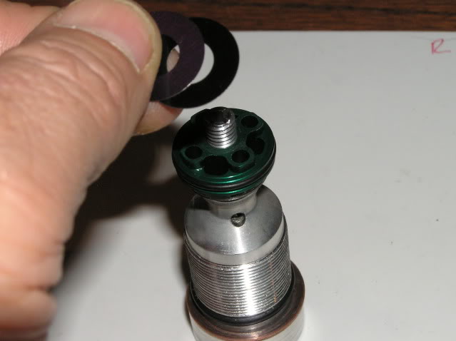

Then you slide the green valve on with the oblong holes face down onto the stack of shims.

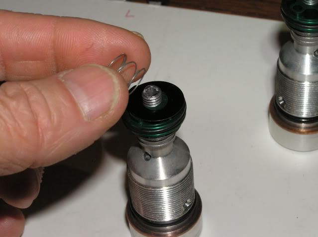

Then you put the check valve spring on and the purple cup nut on the top and tighten it up.
