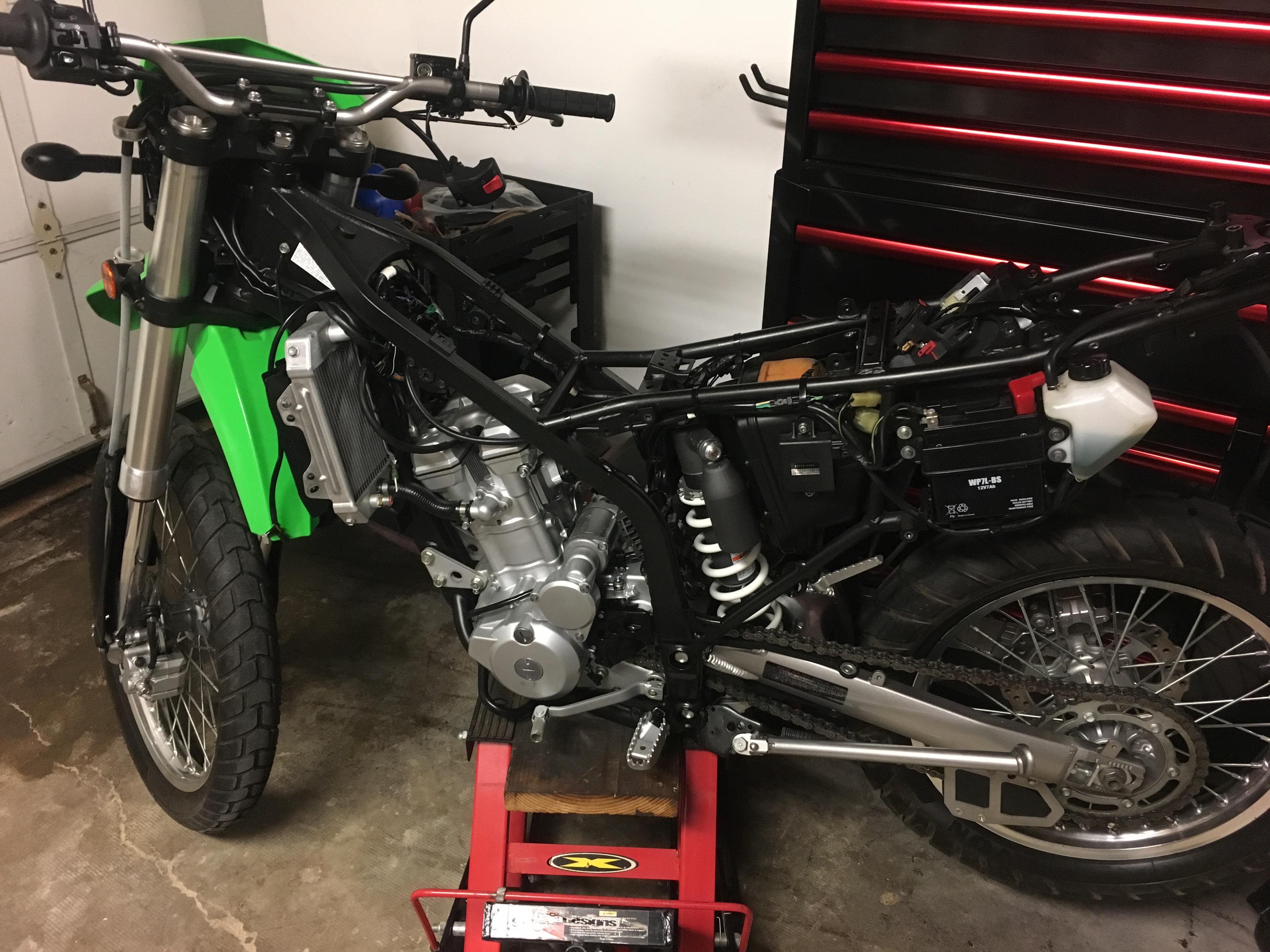

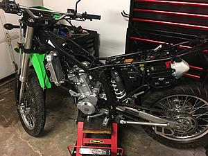

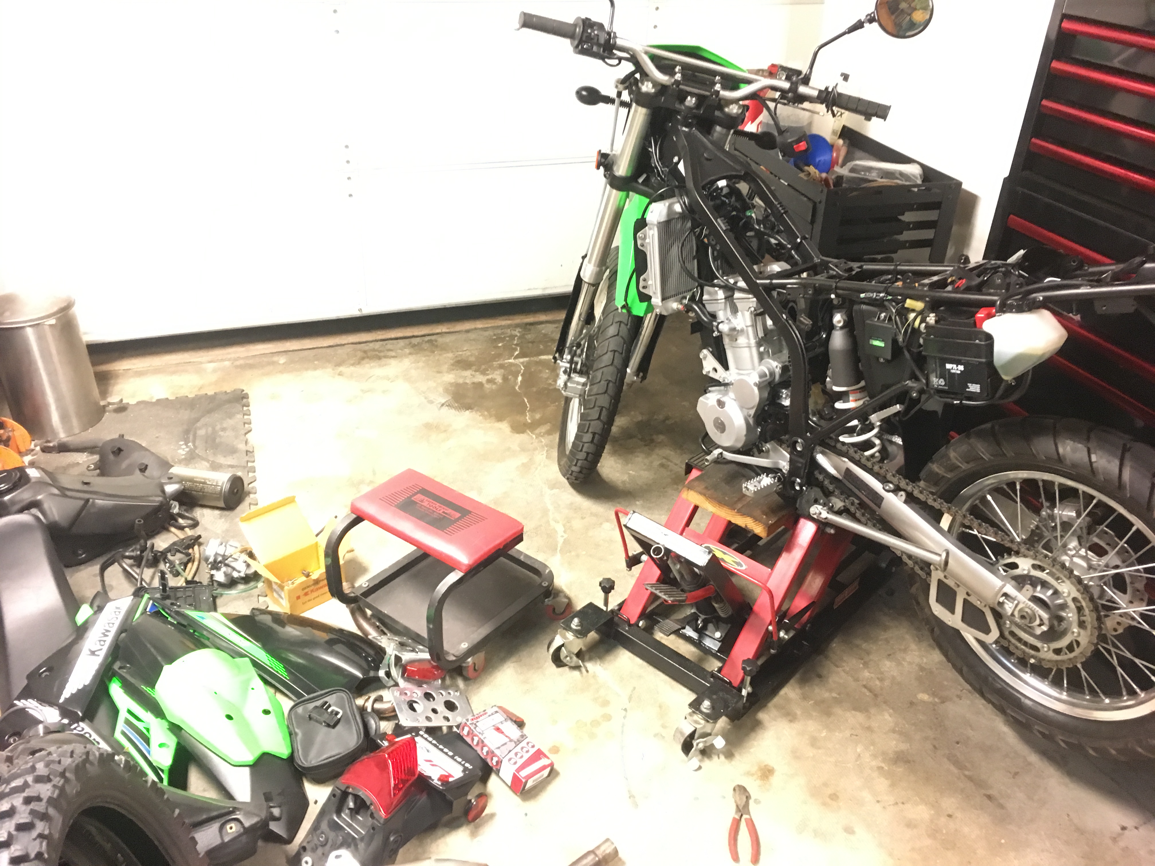

Got the bike after the dealer rebuilt the rear shock. Then tore into it... plastics seat n strap gas tank air box lid exhaust system carb kickstand sensor rear fender assembly horn were all removed.

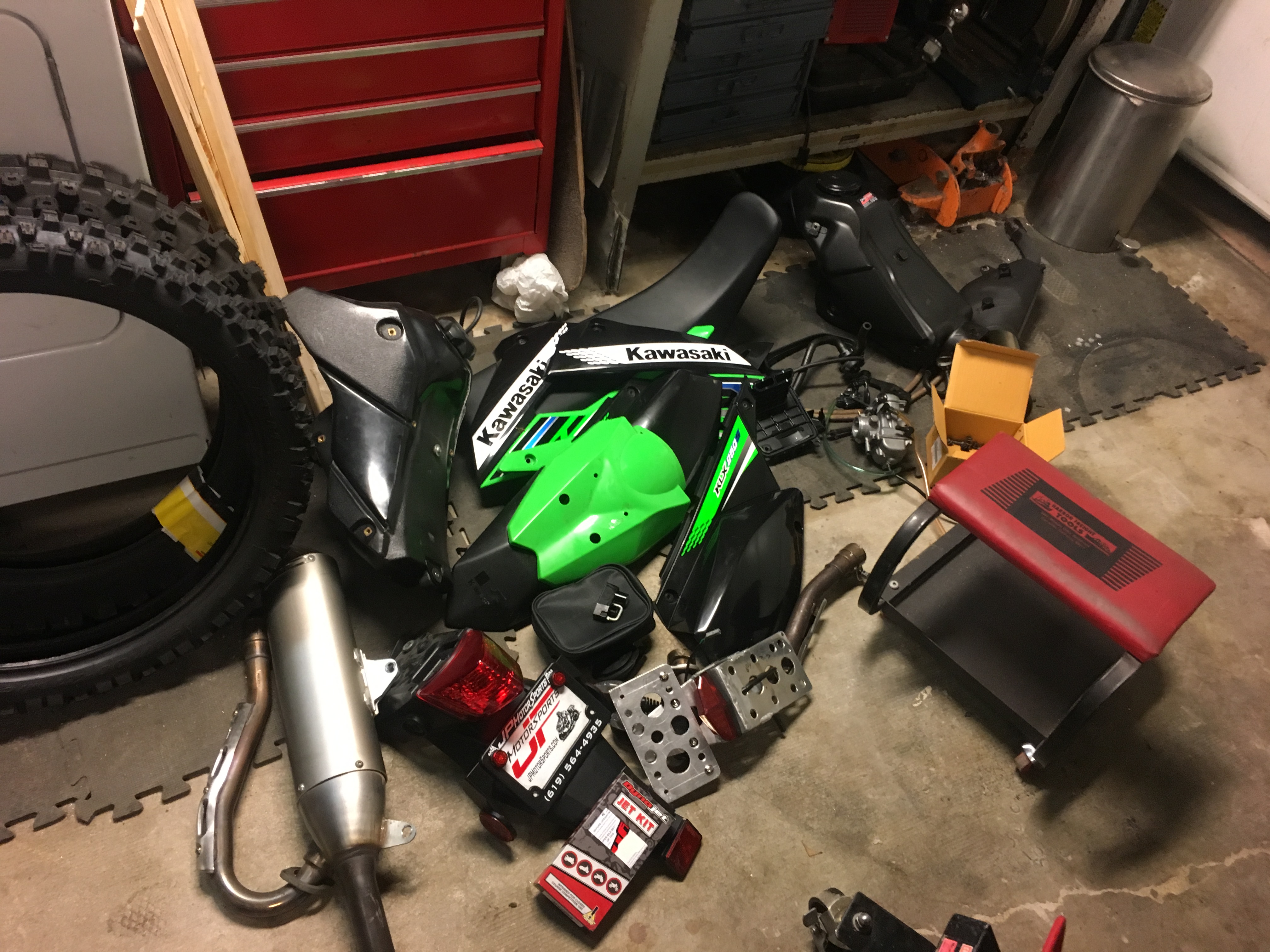

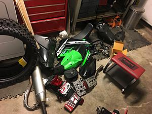

Had a decent pile of parts.

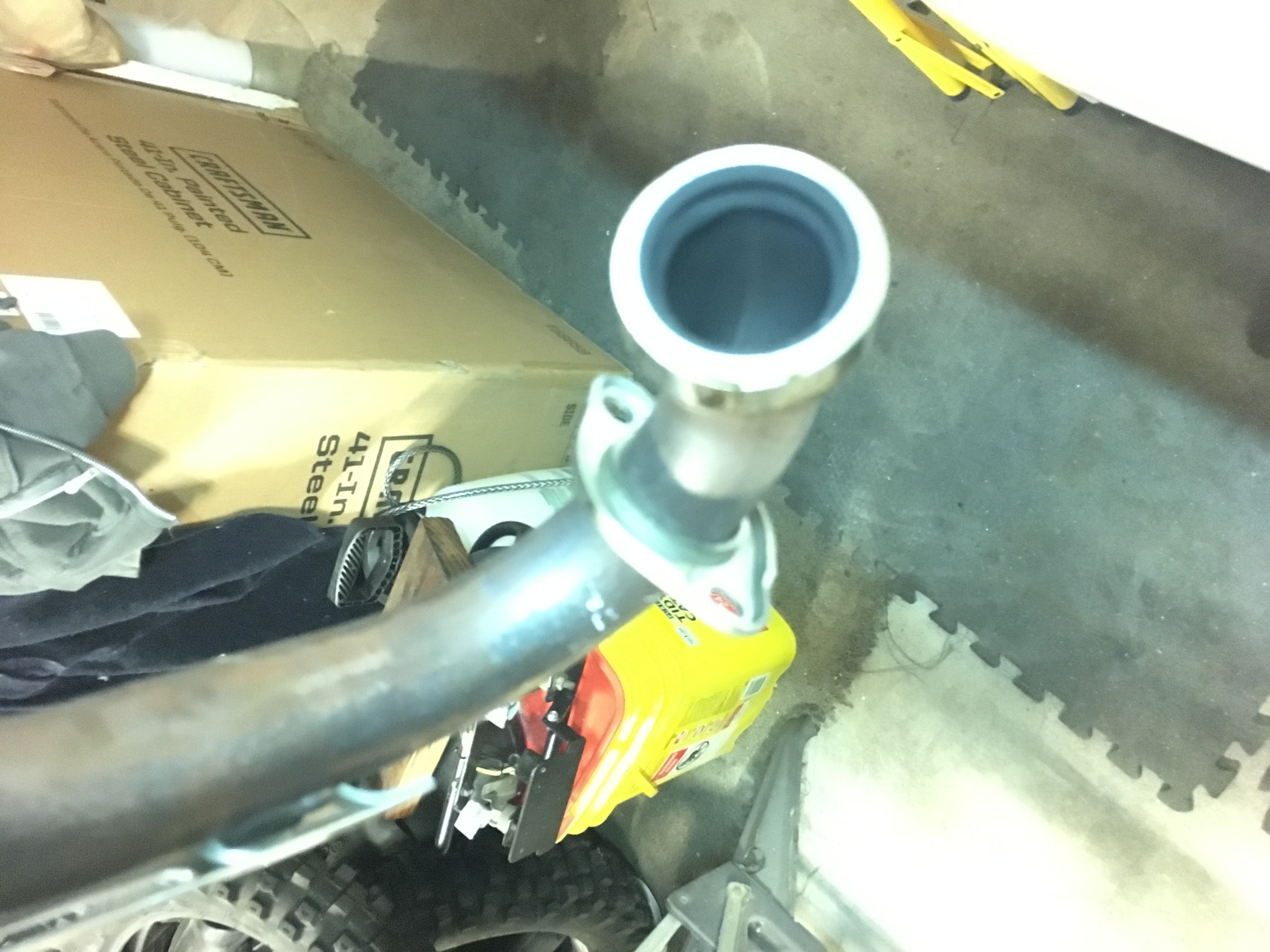

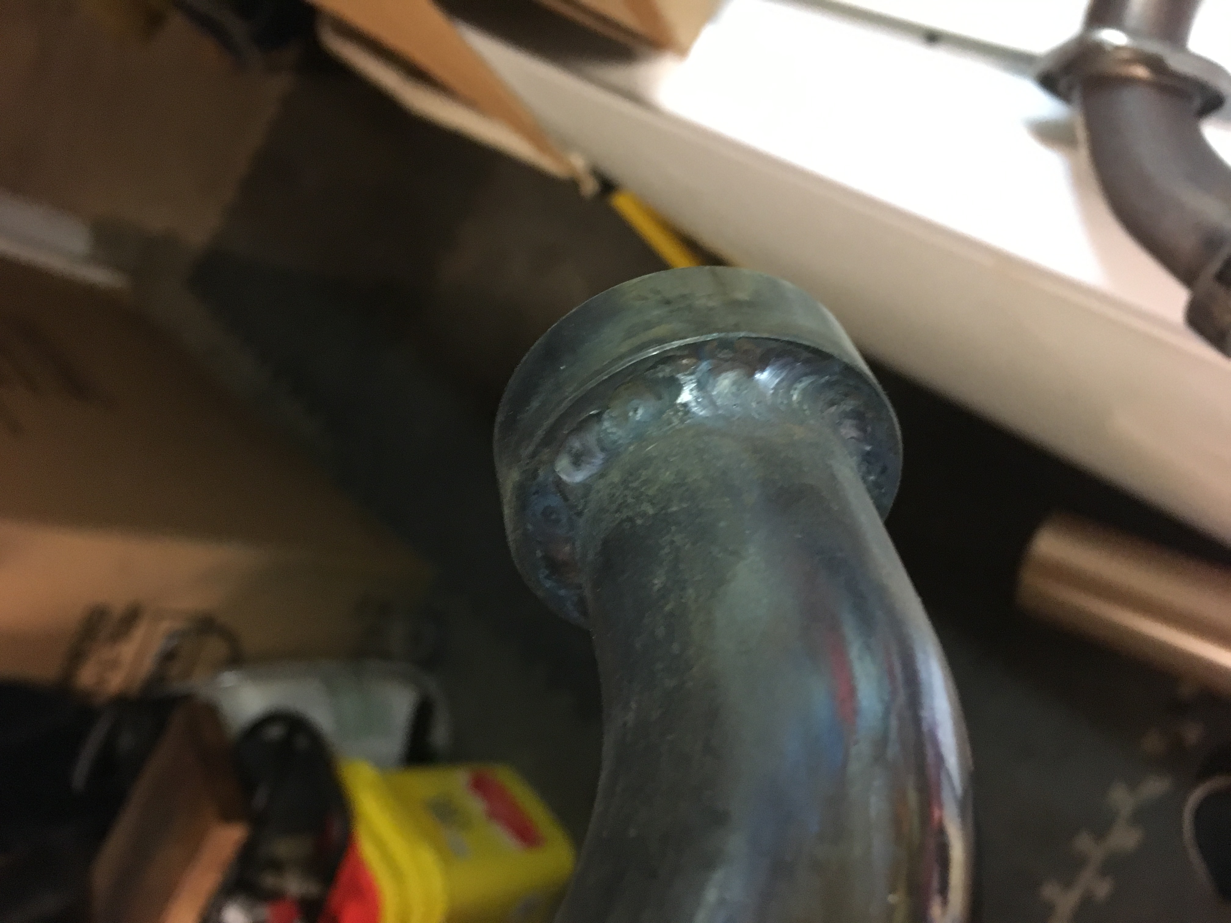

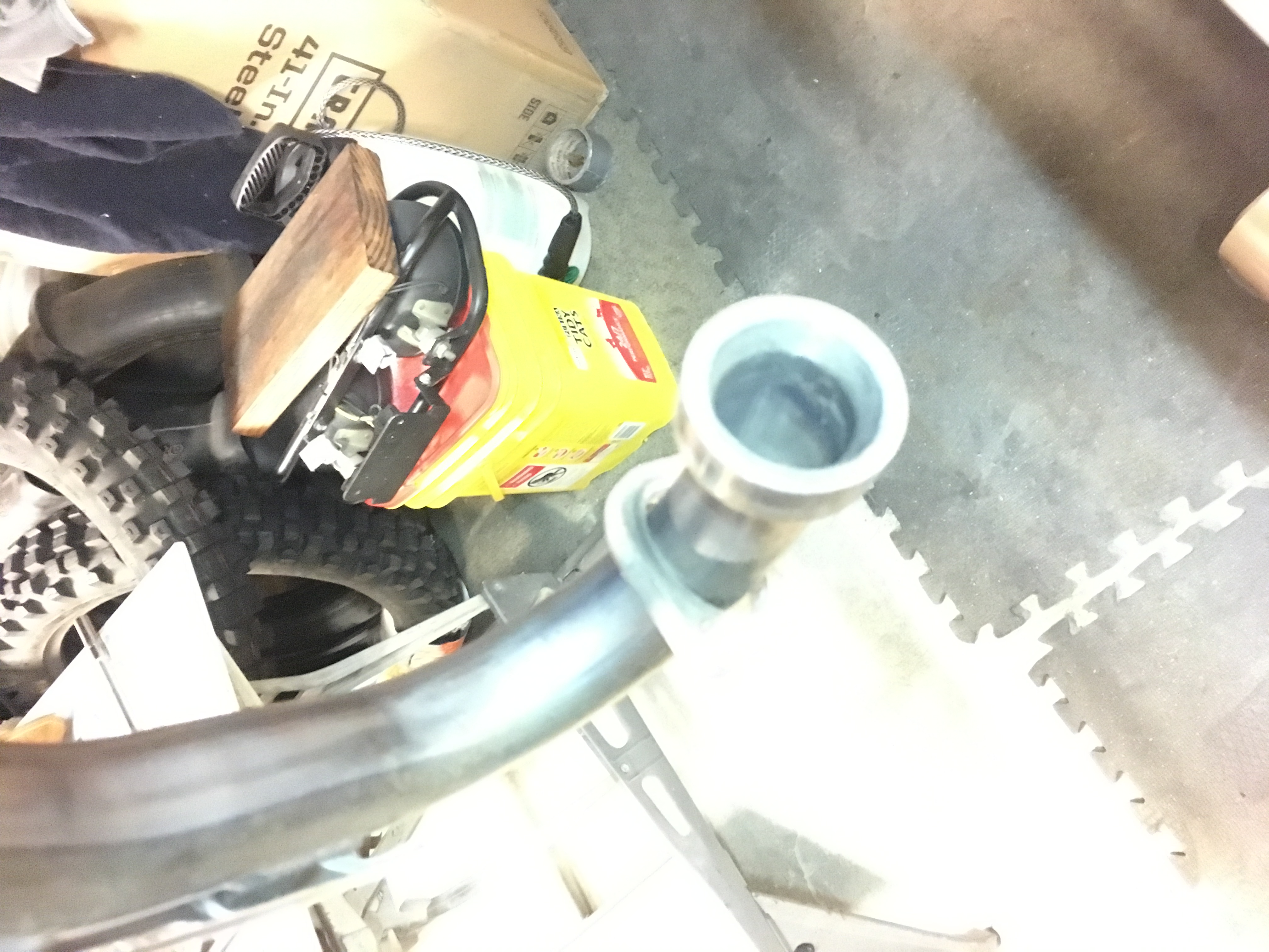

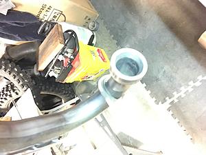

Started with modifying the header, grinding out the internal weldbead impeading the flow and matched the header I.d. With the cylinder exhaust port. You can see the mismatch. And when your working with 18 mind blowing hp every bit of efficiency counts.

Finished strengthening the header since I ground out the internal weld bead. The video wouldn’t load up so , here’s a pic of the rear fender eliminator, the fmf exhaust system is installed but stilll trying to find a power bomb or megabomb header. Installed the dynojet carb kit 2206 but need a 38 pilot jet to omplete that. Cleaned up the wiring to the rear fender, the horn, radiator sensor, and the loom over the cyl head.

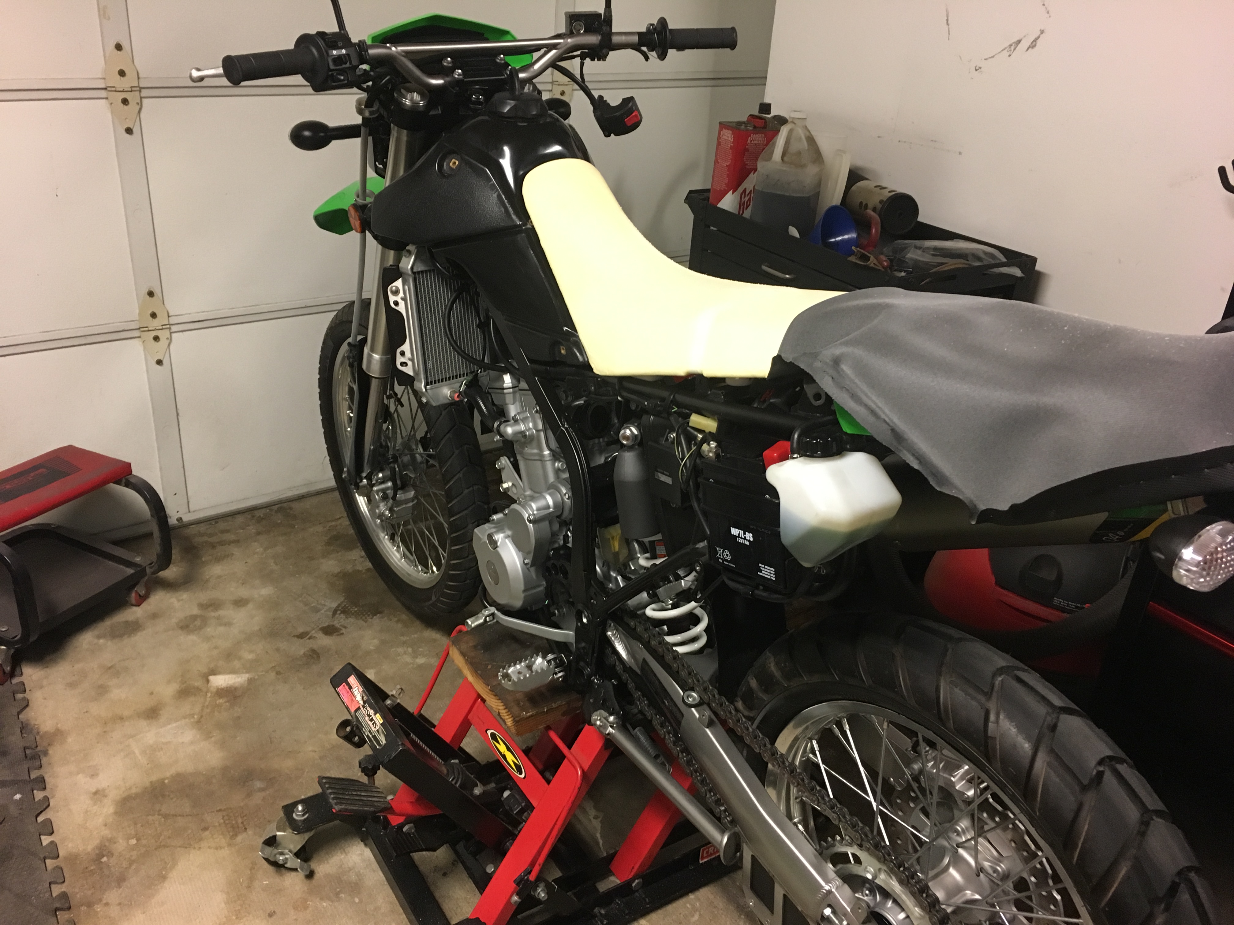

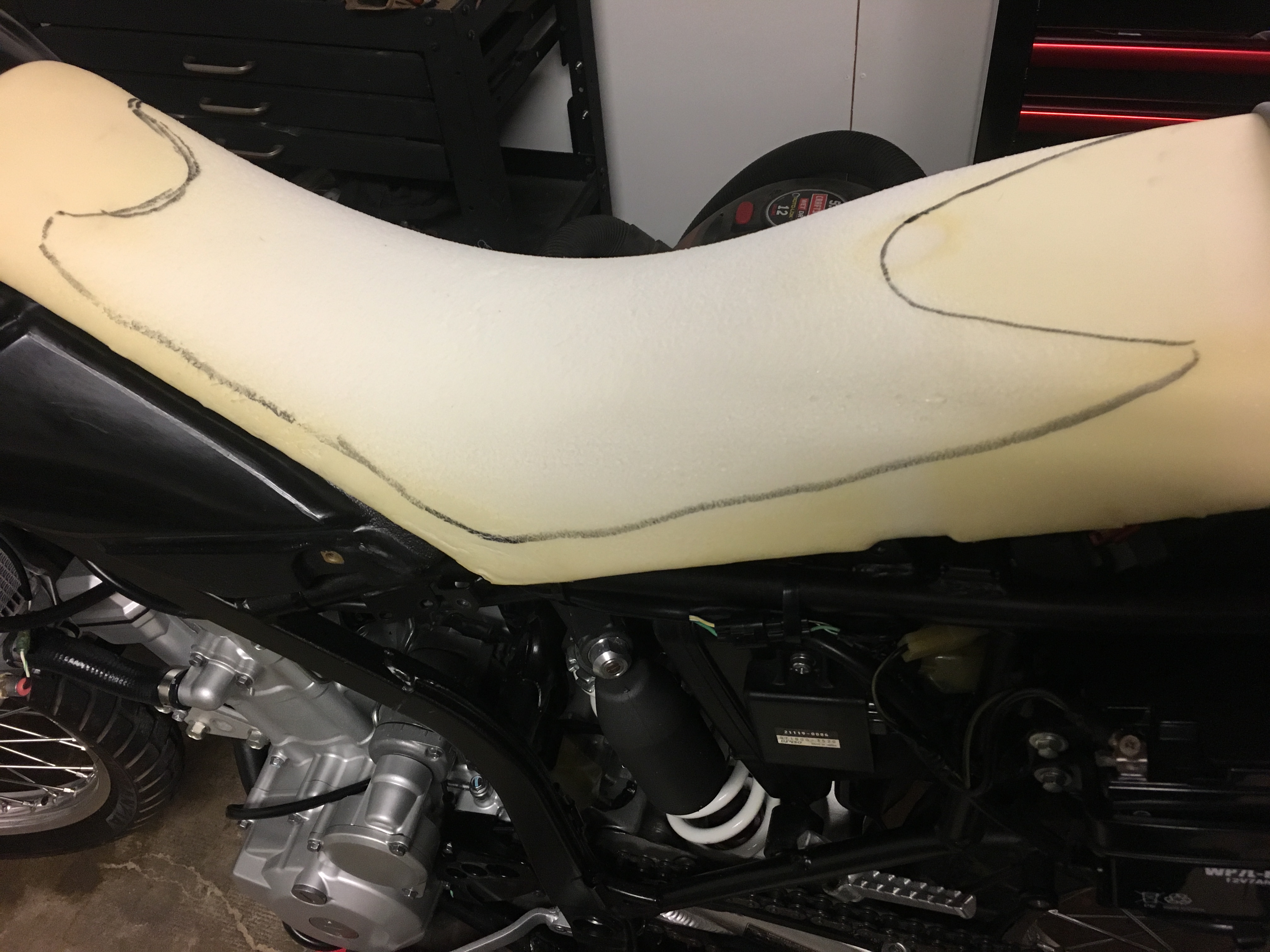

Currently waiting on drc oversized foot pegs, a trail tech rear rack, pro taper cr-hi bars, 38 pilot jet, aluminum 3/16” plate material to fab up a skidplate. Working on shaving the seat foam down for a height challenged female rider.

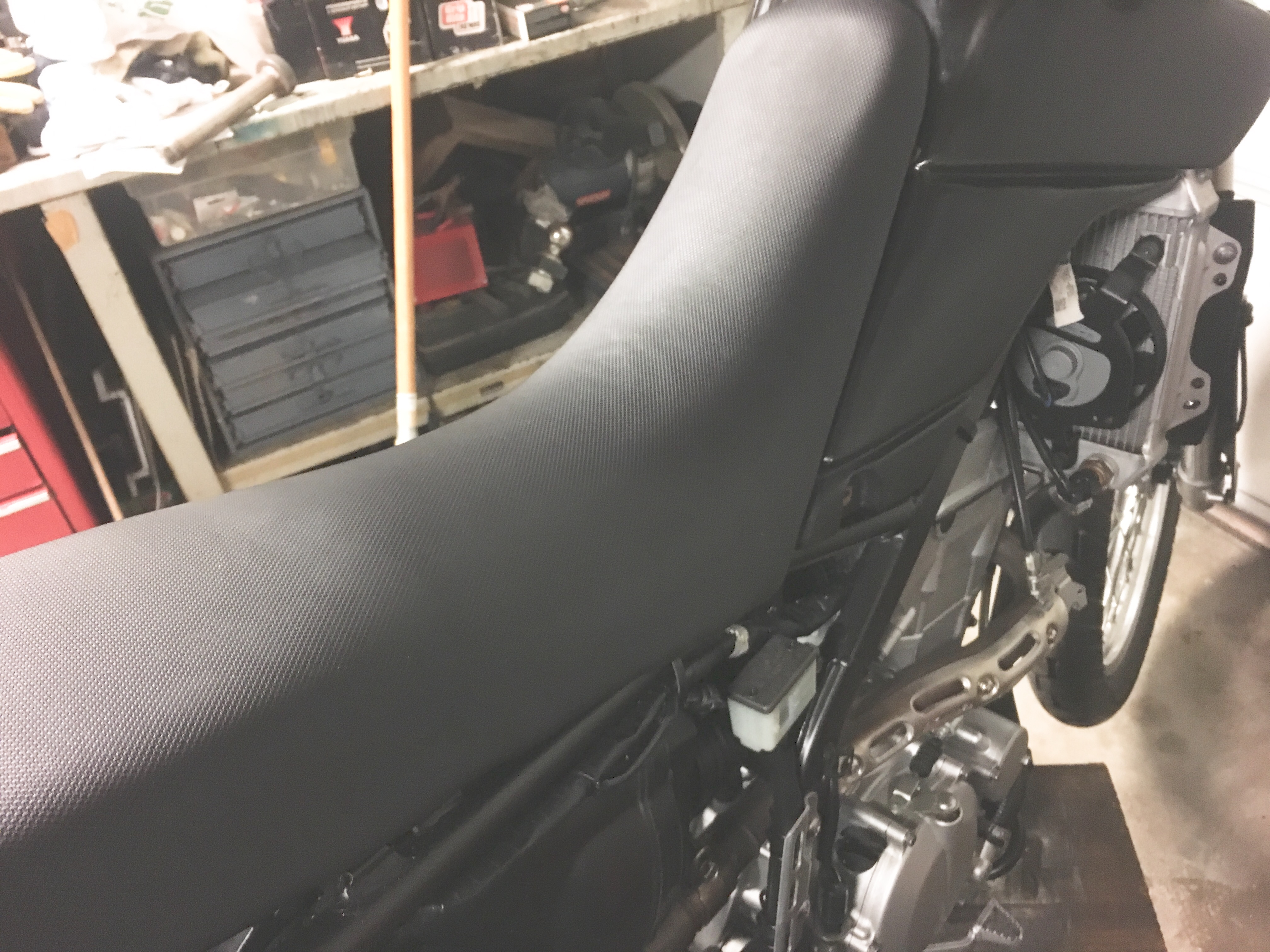

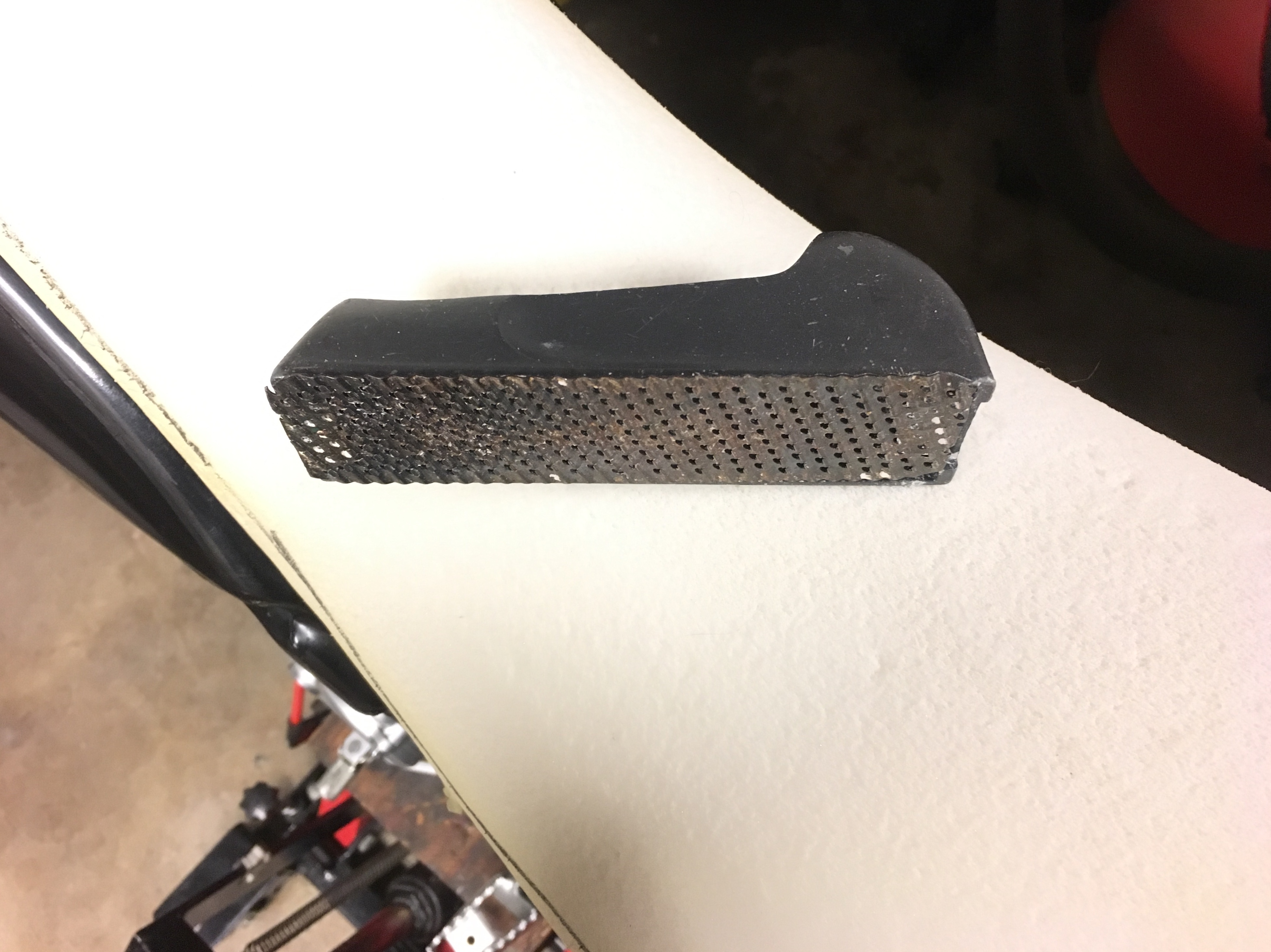

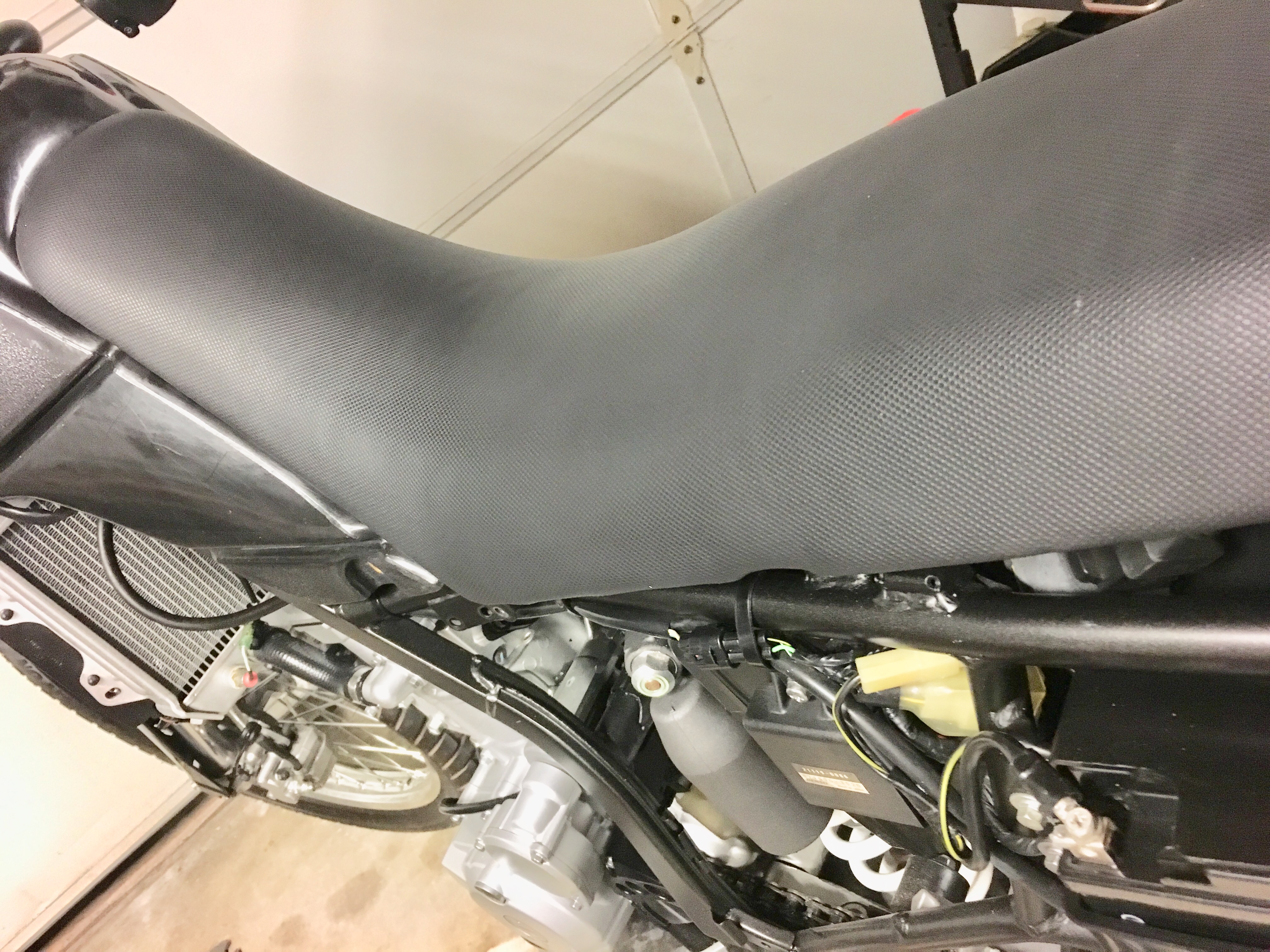

The seat foam shave worked better with a black n Decker surform hand tool than the air tool with a large sanding disc on my seat. I’ll go back n redo that later. Stapling the cover would have been way easier if I had set the pan n cover out in the sun but reattaching the cover turned out pretty smooth
