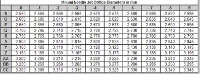

Ah here we go; 159 series (TM36-68) needle jet diameters and a chart showing where those dimensions are typically measured

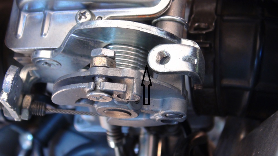

Using a counter-sunk 5mm screw (that won't hit my fuel line) and a couple nuts I had on hand, I made up an easy throttle stop that opens the carb to exactly 1/2 throttle when I hold it to the stop and the nut hits the front of the TM36 bracket as indicated by the black arrow
Doing some testing on the very slight uphill grade nearby, I found I had to hold the throttle at the stop in a high enough gear that the engine just didn't buzz through the rpm range.
With my needle still set at full rich, I noticed some burbling and the plug was dark, so I moved the clip up to the 4th groove, put in a new plug and went for one test ride chopping the ignition and coasting to a stop before pushing it up the driveway.
The new plug didn't look like it'd been run at all other than the ground electrode having a tan color on part but not all of it.. so next time I'll warm it up with the old plug and switch back to the new plug...I might put the needle at full rich again just to double check the new plug
OR put the leaner "51" needle in it at full rich? Hmm it might clear up that burbling
