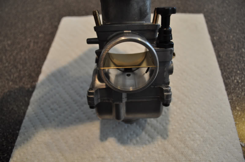

Another happy TM36-68 install on stock bore
My CV carb was having trouble with the float sticking/flooding so I went ahead and put the 36mm pumper on it
WOW
much better !
Like bolting on a supercharger or something
A quick trip up on down the road and there's no flat spots or stuttering etc. I did a WOT plug chop but haven't pulled the plug yet...I think the 130mj may be rich here at 120' ASL but we'll see. It went through the gears nicely but sounded fat
I think the 17.5 pilot jet may be rich because it won't take any choke at all when starting it cold-though 'cold' here in the Philippines is never below 75 deg or so. But otherwise no low speed running problems. I need to double check my idle mix screw setting
Thanks to those here on KF who'd done the 36mm mod and had the jetting sorted out
I have the accelerator pump 'open' adjusting screw just about all the way in, and though the increase in power right off idle is nice and everything, I may take that little spring off the adj screw and use a nut or spacer to allow a little more throttle opening before the accelerator pump kicks in
So, thinking you can never have too much power.. I ahm just happened to notice the TM40-6 pumper carb has the same external dimensions as this 36mm and with a BB 331cc kit due here in 2-3 months the mind starts to wander
The area under the carb flange on the cylinder head is a little thin I think for making that opening very much larger, but when I have it off to add the 331 piston, I could have a local shop lay some weld under there to then allow some porting to take that intake port flange area out to something nearer 40mm
The OE intake manifold will accept a 44mm spigot-I tried it with a piece of plastic plumbing-and I think the OE manifold can be opened up a bit.
If not I'll buy a 40mm spigot to spigot connecting hose when/if I order the bigger carb and bolt the carb on that way with a fabricated intake manifold.
It sounds like too much carb I guess at first though, but the 250 engine isn't objecting to the 36mm :shrug:
If a 40mm pumper carb turns out to be a tad large for the 331 I can 1 or more dividers downstream of the slide to maintain velocity like on this photo of some other carb from the internet
Or sell it to someone with a 650cc single etc

RA, your choke is in a totally different place than mine. In fact the carb looks a lot like the non-pumper Mikuni 36 that I've seen advertised. I know your market availability may be different than the U.S., but could you show a pic of the accelerator pump linkage on that model. Makes me curious.
Right you are, but that's not a pic of my carb; just a pic of a carb off the internet that's had the divider added
I've edited my original post to clear that up
Here's what's on there now
