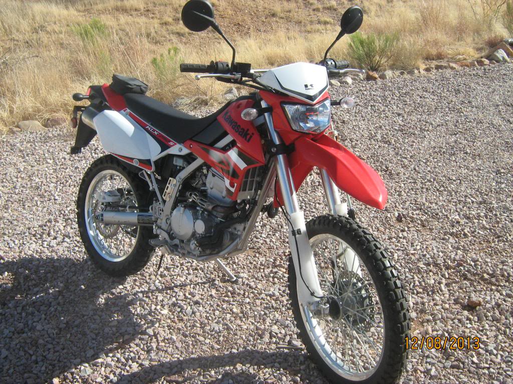

Picked up my '09 last December with less than 600 miles. First thing I did besides carb mods was the 600 mile check-up including checking the valves. They didn't need adjustment, but I did struggle to get the valve cover and it's gasket remounted. In that it was dripping oil, I lost the struggle. Took the cover back off and remounted the gasket (which barely fit) with some sealant. No more dripping of oil, but after 100 miles or so a coating of dirt soaked oil was building up. Bought a new gasket, which fit much better and after another 100 miles or so there was no more oil film buildup or leaks.
