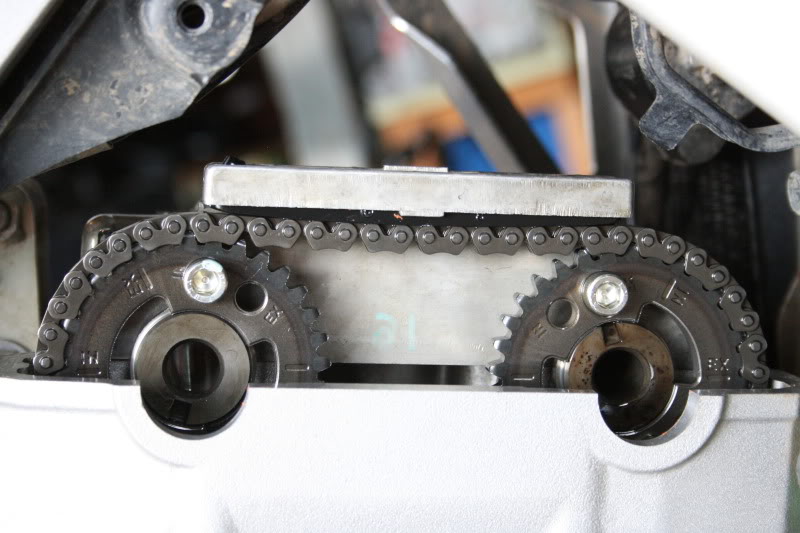

OK, Kind of a PITA, but today I went ahead and tore into the bike to check the timing and valve clearances like Bill Blue suggested. (I'm going to find an old 8mm socket and weld it to some rod to make a nice T handle wrench)
Timing looked fine.

Yeah, you don't have a cam timing issue there with that pic. Dan, is your engine exactly at TDC in the pic? My worn out chain caused my cam sprocket marks to be a little more off than yours, but my new chain had those marks dead flat with the valve cover surface at TDC.
Your comment on the noise possibly getting quieter when reinstalling the tensioner might not be weird. I got mine to quieten when I reinstalled the tensioner even when I had a worn out chain. My cam timing marks were slightly off at TDC, but the chain quietened. I didn't see anything wrong with the tensioner, and I don't know what I did to it to make it quieten the chain. I'm not saying that your case is the same, but I don't trust this tensioner design.
