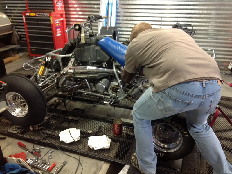

I am kind of amazed at the hp of the klx350. 27 or something like that.
I went to help do a pipe dynoing on a 500cc atv with 4 different pipes. 75 freaking hp! I had to buy it. When it hits the powerband you have to be ready cause it will loop out on you. Makes you almost cry riding a stock klx trying to do a power wheelie!
Well pull that 500 motor out and wedge it into your KLX frame!

looks like 500cc two stroke... not really a fair comparison ;-)
