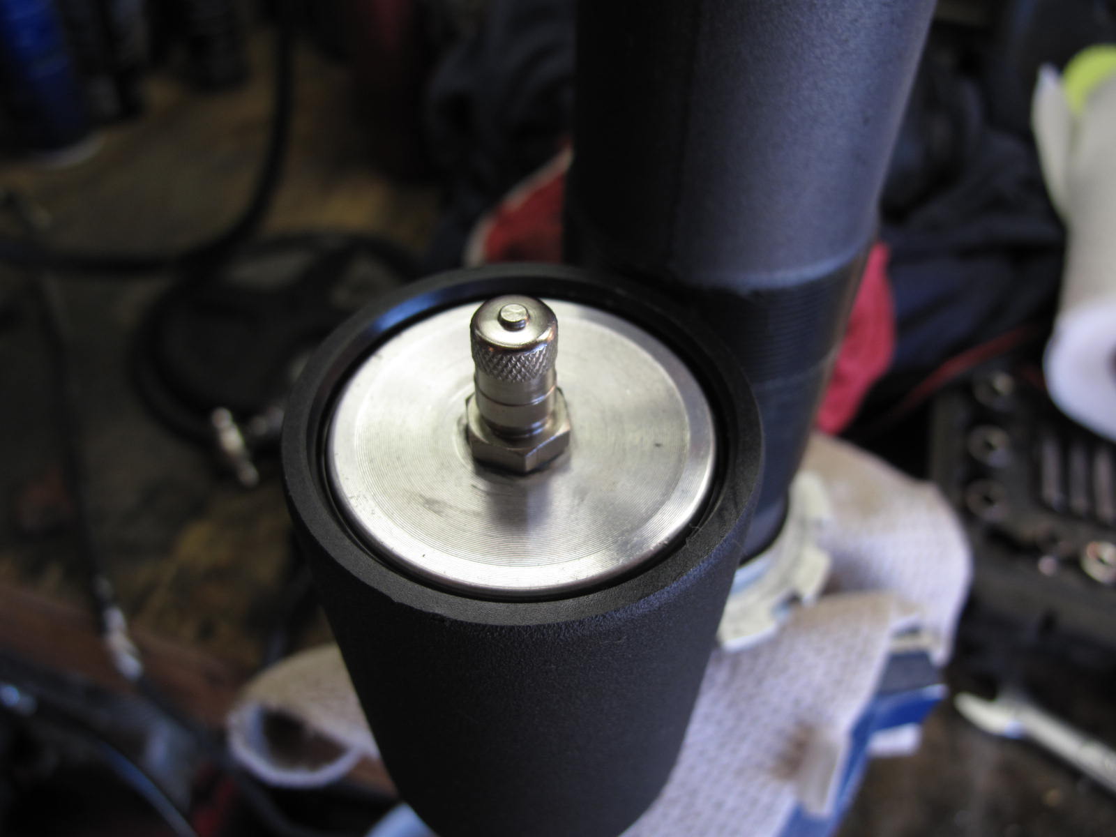

I got the schrader valve in last night. Used JB weld for thread locker. Very straight forward, drill, tap, install.
The shock is back on the bike and seems to work like it's supposed to. Weather I like it or not, time will tell.
5 wt shock oil
160psi nitrogen charge.
Minor change to the valve stack. I moved the crossover one position closer to the valve. Might make it a bit softer. We'll see.
I'll start another thread on valving.
RM14
